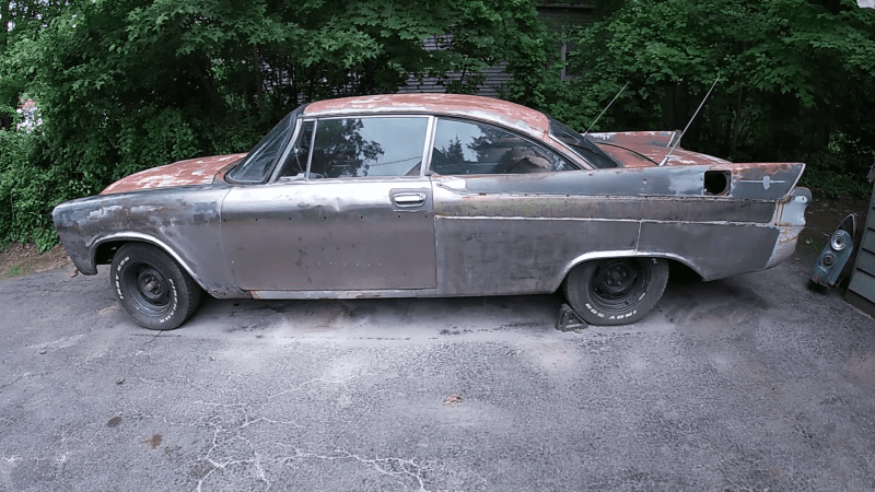

OK, this is off topic, but at least its Mopar. I tried to sign up to the Forward Look group, but it didn't work, so I am asking here.
There's a 1958 Coronet 2 door sedan here that somebody I know wants to get rid of very, very cheaply ( 1000 bucks). I have only seen the car from a distance but I said I would come over and check it out. It's very straight with the original paint (looks like it) and shes nearly complete with only a few missing trinkets. Factory big block too
( 350/361?) Pushbutton automatic.
I have three questions:
1) What are the problem (rust) areas in these cars I should look for?
2) What is the deal with the differences between a 2 door hardtop and a 2 door sedan. The 2 door sedan looks almost like somebody just bondoed in the back door.
Part of why they're so fugly I think, (IMAO). Did they use a different roof from the 2 door hardtop or what? Different wheelbase? Are the door lengths different between the two types? I just cant tell, it just looks weird . The door looks stumpy and that back quarter windows too long ( IMAO)
3) IF the door lengths are the same could one convert it over with a lot of work?
If this was a 2 door hardtop I would be all over it, but it also wouldn't be 1000 bucks. Would make a cool driver to run around town in nonetheless.

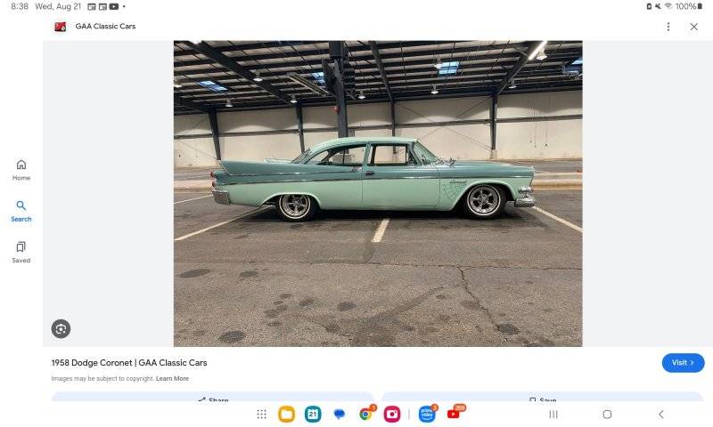

I believe the hardtop and sedan, or 'post' might have different doors, but the wing (vent) windows are different btw the two, post vent windows are smaller. Could be due to the post, though 4-doors and wagons had the smaller wing windows. Note, the photo above has the larger windows and the verts did as well.

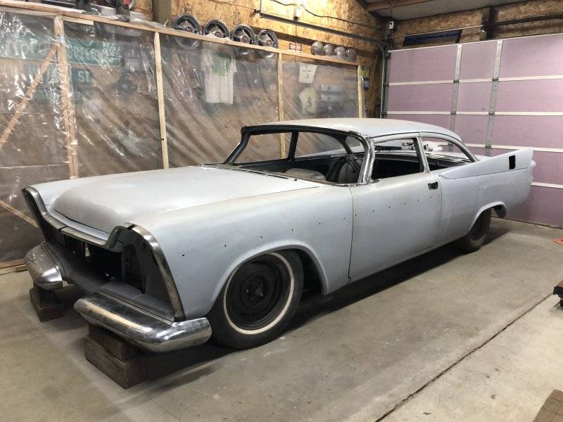

1) Rust can be anywhere. These cars are very rust-prone. Floors, trunk pan, rockers (inside and outside), bottoms of quarters, bottoms of fender, eyebrows over the headlights, bottoms of the doors, trunk lid and hood seams, front and rear window channels, roof right above the sun visors, firewall air box, and in the quarter seam under the stainless side trim. Expect zero help with replacement sheet metal. What is out there is absolute garbage. You will be making all your own panels if needed.
2) The 2 door hardtop has a lower, shorter length roof that also slopes down faster at the rear. This shortens the height of all side glass plus the length of the rear side window. That's why the hardtop looks so much more sleek. 2 door sedan and hardtop do not share any glass, the roof, or doors. The dutchman panel between the bottom of the rear glass and the deck lid is wider by maybe 3-4 inches on the hardtop due to the shorter length roof. Wheelbase and most of the rest of the car between the two is the same.
3) You can convert a sedan to hardtop (anything is possible), but it is no easy task. You would need an entire donor roof, glass, doors, and tops of the quarter panel. I'm guessing window regulators may also be different.
