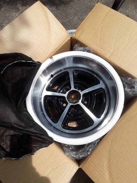

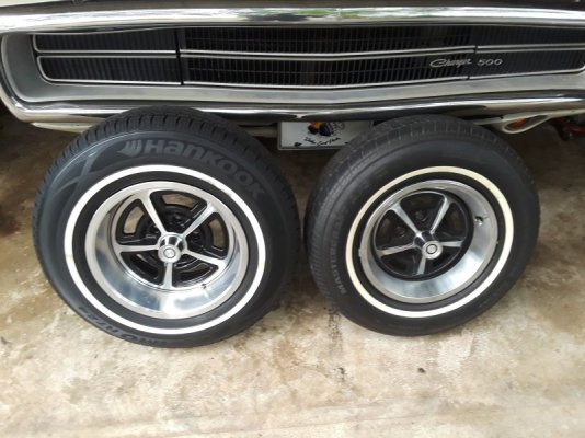

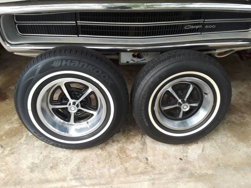

Right at the end of 2020, doing an upgrade to front discs, I bought these 15" one piece alloys from Dynacom; they were listed under Ford, but Ford/Mopar wheels can swap. Since my Magnums had trim rings, I wanted to get as close a match to original as possible. I'm VERY happy with the results! 15 Dynacorn Alloy Wheel.jpgNew vs Old Magnum Wheel.jpg

Those look really good. The only real difference I could find is the dynacom 15x8s have a 4”bs vs the wheel vintique’s 4.5”bs. Maybe there are options, I didn’t research for too long.
Let’s see a pic of them on the car.

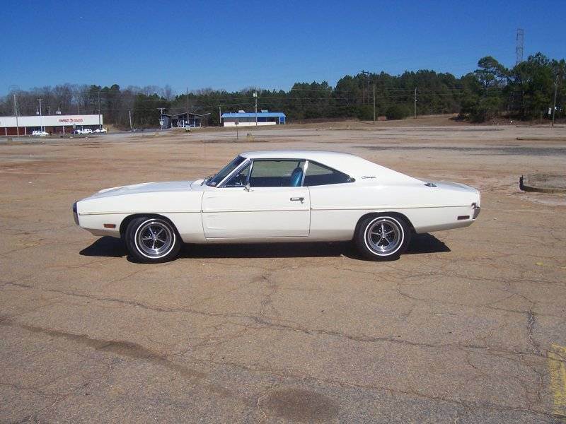

The local wheel/tire and frame shop was supplying bells. So I took some 14” Magnum’s to them. They put 15x8 bells on with a 3.5” back space.
Have driven it to Jefferson City Missouri, Rapid City, Minneapolis and Detroit. Never had a problem.
They have been on the car since 2006.

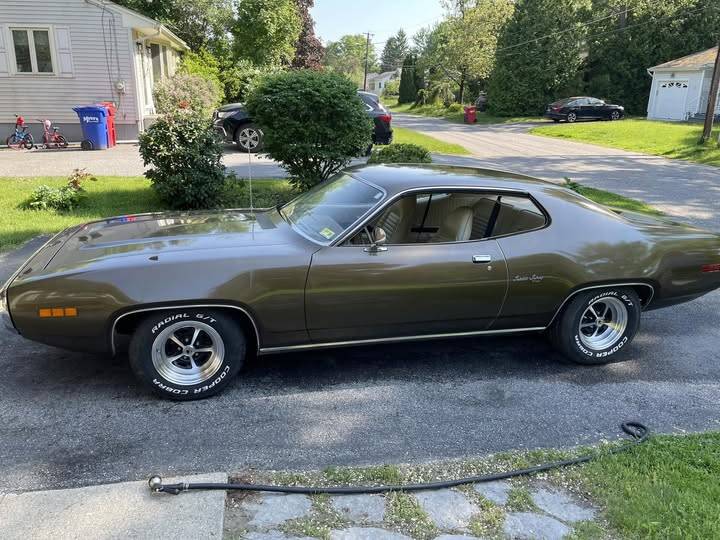

Here's what the aluminum Magnums look like.

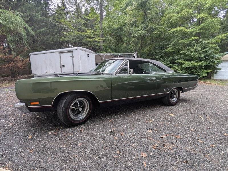

Thanks for the thread. So the readlines on my GTX were getting about 20 years old so I put some cheap radials on it just for safety. When balancing I found out three of the wheels are bent. Seems lots of wheels are bent anymore? I dont know whether to spring for the aluminum or just buy steel wheels and pint them body color with poverty caps? Are the steel wheels coming to folks straight?
I will attach a photo of the car for some suggestions. This is a real GTX but not numbers matching but I am trying to bring it back to pretty close to the original condition you might say..
Thanks for the help..
Definitely NOT steel wheels with dog dishes, please!
Thats kinda the point of the thread - seems like all the "Magnum 500s" these days are junk; bent, out of round, peel-ey chrome etc. Folks seem to have to send multiples back to finally get a good set. No one has been able to say 'Look-brand xyz is quality'. Just doesnt seem to be happening these days.
There are places that can and do straighten steel wheels to make them run true. The issue is rechroming. And since Chrysler never offered the 'road wheels' in 15", youre kinda stuck with aftermarket if thats what you want.
Im leaning towards the aluminium versions myself.

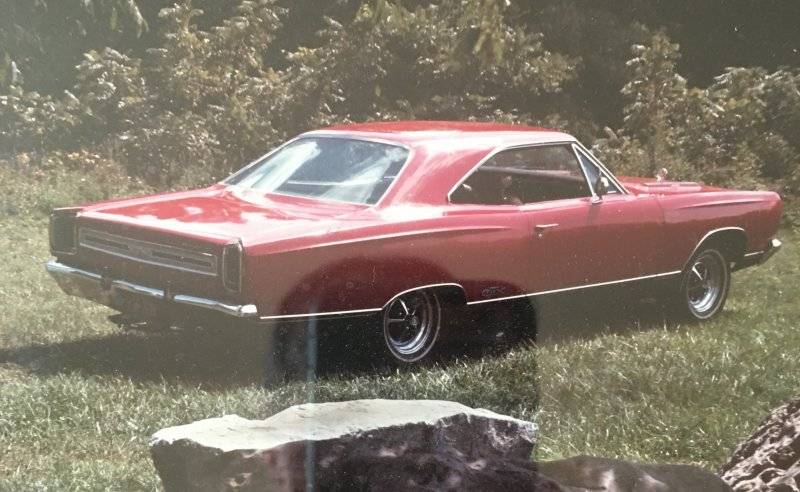

Most guys here don't like 14 inch wheels and go 15 or larger. I run 14s because I have a near concours numbers matching GTX that wore them when new. I mention this because I sold a set of mint older trim ring Magnums that ran true to a fellow member here two years ago when I put a set of chrome wheels in their place. My car originally had chrome rims dealer installed, so that's how I wanted it. My used set had 1000 miles on them, and I sold them for half the price of a set of new junk.
Older sets of the 14s come up for sale with some regularity, IMO look good on an original car, and can be a good alternative to rolling the dice on the current stuff. I cheated a bit, and put G70-14 tires on, one size up from factory stock, fill up the wheel wells a bit better.
Stock magnums with trim rings are called road wheels, no?
That's correct. When they were announced for the 1969 model year, the dealer who originally owned my car wanted no part of them. His previous GTX had the chrome rims in 1967. He ordered the car with dog dish caps, and put the chrome rims on when the car came off the carrier. He used two of the painted steel wheels for snow tires the five years he ran the car as a daily driver. The chrome rims are written in on the original window sticker, priced at $80.
The guy who sold me the car didn't trust the sticker, and went with the trim ring road wheels when he restored it. I knew better, because I drove the car when it was new, and took photos to back it up.
