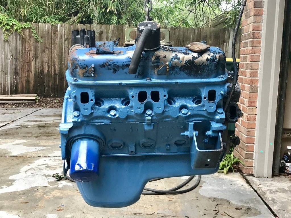

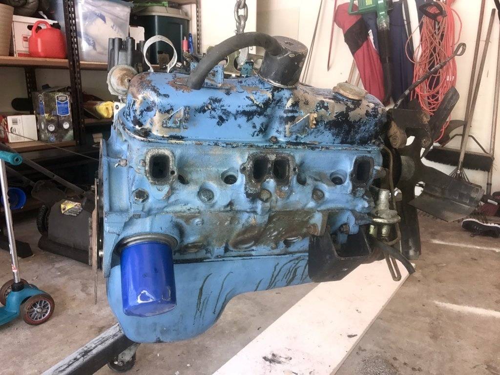

I just swapped in a 1978 360 engine. All is good but my oil filter leaks (slowly) onto the exhaust pipe. I'm on my second filter (K&N first, now a napa gold) in two weeks. Both leak the same. Is there a trick to this? Special filter? This engine came out of a Karry van.

Don't know. You can see it in the picture.

Since this engine sat on the ground with the filter on, I'm thinking it may have rested on the filter and warped the plate. What is this plate called? I need to just replace it and need the name of it.
I'd be surprised if the plate was warped, take it off and put it on a flat surface and check it. I'd still bet the gasket behind it is what's seeping.
