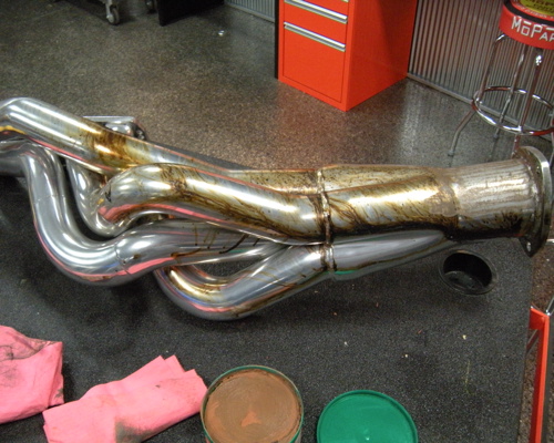

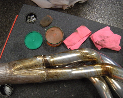

i've got oil inside my bellhousing too, but can't tell where it's coming from as it all gets blown around. even getting on the pass, side header collector!

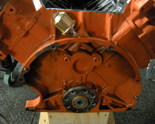

I too had/have the very same damn problem. On the old motor it was leaking oil out the bellhousing and just covered/baked oil on the new TTI headers and exhaust. Installed a new RMS and kept doing it. Pulled the old motor for the new motor, and could not find one damn wet oil spot to hint where the oil was coming from, back of the block was bone dry. :angry1:

Not sure about small blocks but on an RB your choices are: Rear block face cam freeze plug, horizontal oil bore plugs, rear main seal. On the top of the rear block flange: the sending unit port or the plugged vertical oil bore plug. I'm sure there are more savvy guys that can help..... Hello Budnicks????
