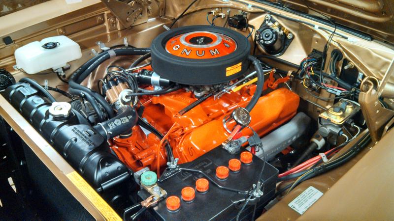

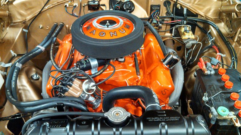

I have a newly rebuilt 440 RB stroked out to 496. Runs great but it has a persistent oil pan leak at the rear of the pan. I am running a stock 402 pan with windage tray and have tried every gasket available (currently running Moroso Silicone with Steal core) and even used silicone sealant. It holds for a couple of heat cycles but eventually starts to leak at the rear of the pan after 4-5 trips. Also had leaks at the valve covers and Fuel pump but stopped them using Silicone Gaskets and silicone sealant. Could this leak be the result of too much crankcase pressure? I have tested the PCV Valve and it seems fine. No Idea what to do. IMG_20140630_223116_746.jpgIMG_20140630_223128_855.jpg

Really nice job on the engine compartment. There are many, many posts on here dealing with oil leaks from the rear of the motor so I won't re-iterate. Good luck.
