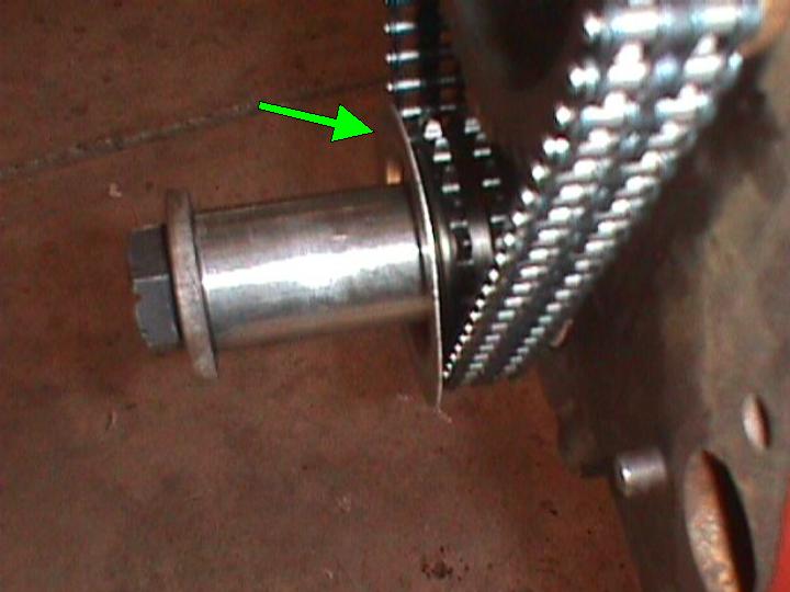

Anyone got a photo of how the Oil Slinger gets installed on a 440 ? What holds it in place other than the keyway ? What stops it from moving along the crank between the timing gear and the cover ?
The dished side fits up against the seal. It just sits on the crank snout with the key way holding it. I think the harmonic balancer holds it in further when installed.
Sometimes it's not held in place at all because many forget to put it back on, or just decide not to..... LOL!
Thanks. Now it makes a bit more sense. I had not noticed that the balancer actually extends through the timing cover gasket and will hold the oil slinger away from the timing cover (my first engine assembly - Me and Mr. Google doing it as a team)
Thanks again.
