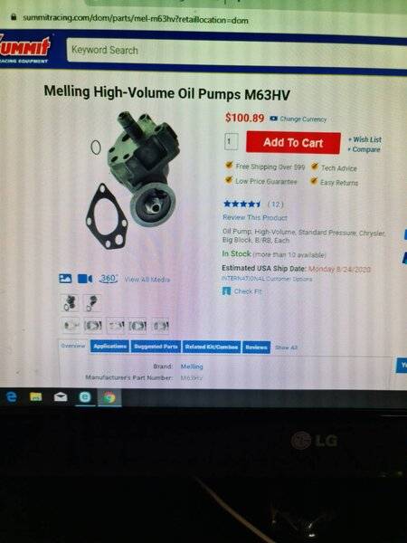

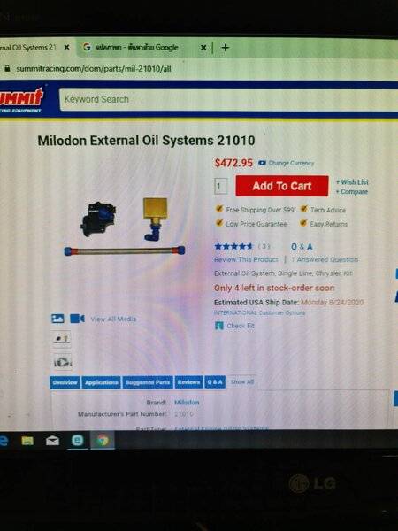

Could you please tell me the difference between these 2 oil System (ExternalvsNormal). And wich one I should go for my 512 stroker SuperCharge.

The Melling M63HV is the "high volume" version of there standard BB replacement oil pump which uses the stock internal pickup and oil pump suction supply passage, stock oil pan. The Milodon system has a special pickup which requires a special external pickup oil pan, and the oil pump cover in the kit bolts to a stock style pump body(either the M63 or M63HV or other pump), the internal pickup is eliminated and stock pump passage is plugged.
I use a Milodon external system and Milodon "road race" pan which has it's own static external pickup on my 512" motor.

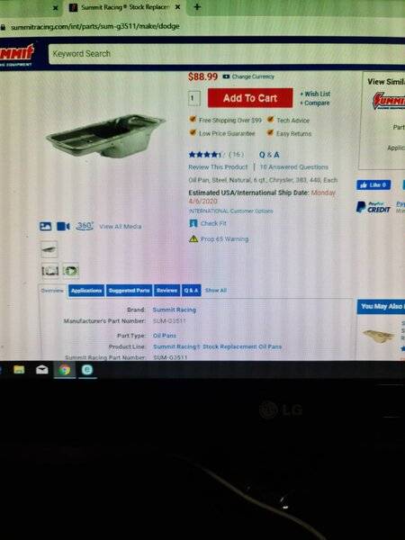

this is the oil pan that I use for my 512,so the choice for me should be The Melling M63HV right?

Yes that oil pan would use the stock style oil pump & pickup. Not sure about the baffling in that pan or which body style it fits, Summit doesn't say which.
If you plan to use that pan, its not made for the Milodon system so go with the Melling.
