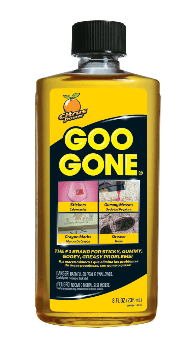

Maybe this stuff to remove the glue/adhesive?
