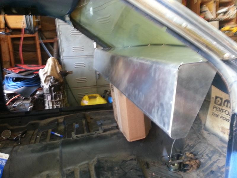

Also wanted to share i got my aluminum dash almost mounted just need the lower supports to make and bolt on.

Yes it is. Hopeing to get this beast around 3100 course have a lot more light stuff to buy but piece by piece.
our rides have tons of extra metal that can be removed for lightening.looks like you are well on your way.
Yea tell me about it lol already have the glass doors waiting to get the front end clip trunk and hood then save up for the cage but prepeing everything for it.
glassing the fenders,hood,trunk,and doors.lexan the windows.pull the heater box and rear seat.that should get you real close,if not lighter,then your goal.
Yea I was planning on lexan windows as well heater box has been long gone, the spec cage I'm going with I wouldn't be able to fit it in anyways :). The cage will be chromemoly, if I can get it lighter then my goal all the more better just means I would be able to keep boost lower
