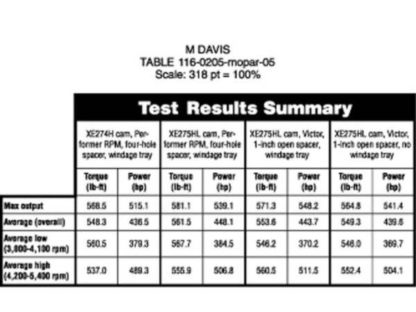

I have the 275 kit that I'm not going to use as I went roller and gear drive but this article was very interesting...I really considered using it and even upgrading the stick to the 285...I just came across a roller deal I couldn't pass up....
http://www.hotrod.com/articles/mopar-440-update/
