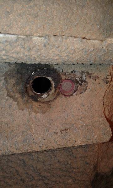

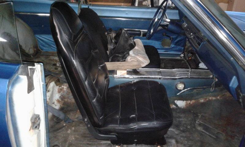

Ok, so in the process of changing the seats in my 68 Coronet to 71 Charger seats, I quickly realized the holes in the floor would not accommodate the 71 seats. As I was chucking up a drill to punch some new holes, I looked underneath and spotted (through the gunk and under-coating) what looked like another set of optional holes in the floor brackets. All I had to do was continue the holes through the floor pan, and viola!... the 71 seats dropped right in. (insert angels singing). These other holes are probably old news to a lot of you, but I was unaware. Just wanted to throw this little tidbit out there.
