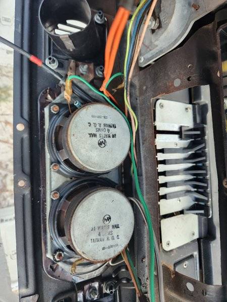

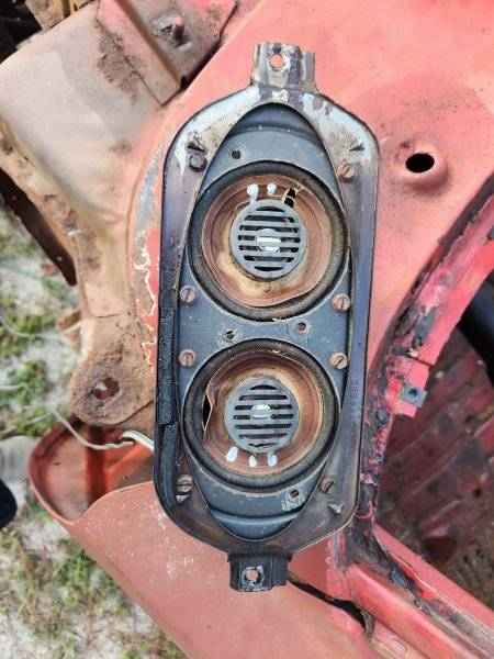

Or…look for a “split frame” that allows two 3” cone speakers to fit the factory hole
Do not know what size your front speaker is. If it's one of the long skinny ones, 2 1/2 or 3 by 9-10 long. S&M Electro in Blaine, Minnesota makes a frame set up for 2 small speakers to go in the same area. You can tie them together or use them like a modern system with balance or fade. They convert radios too. Also pre-wired if desired.
I have had them convert 2 radios with speakers in both of my Darts.
this was in my 70 charger,center speaker
If running the factory radio make sure the speaker is 8-10 ohms.
