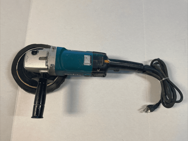

I have the Groits G15 long throw orbital as well as some older orbitals and high speed rotary polishers. The Groits G15 is a serious buffer. If you want even more there is the extra long throw G21 that is recommended for professionals.
Are you shining up older paint or are you sanding and buffing a new paint job?
I have a Makita that I've had for probably 25 yrs. Does a great job. Like everybody knows, the quality of the job is all in the operator.
