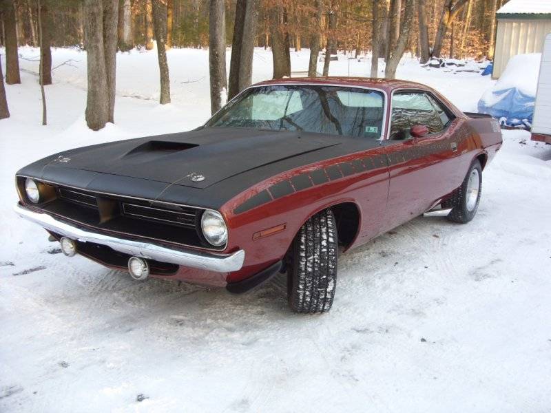

Organosol - authentic black textured finish for hoods, tail panels............
Qt $215.00 ***ONCE AGAIN AVAILABLE*** Pint $ 115.00

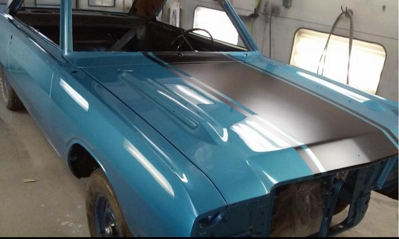

Is the "originality" of using it, that important ? You can get the similar effect from your local body paint supplier.
SEM Hot Rod Black. Done, and you won't have to mortgage the house.
and it cleans up with windex
Very hard to find and keep clean. If you do find it make sure your gun has the right size tip.
