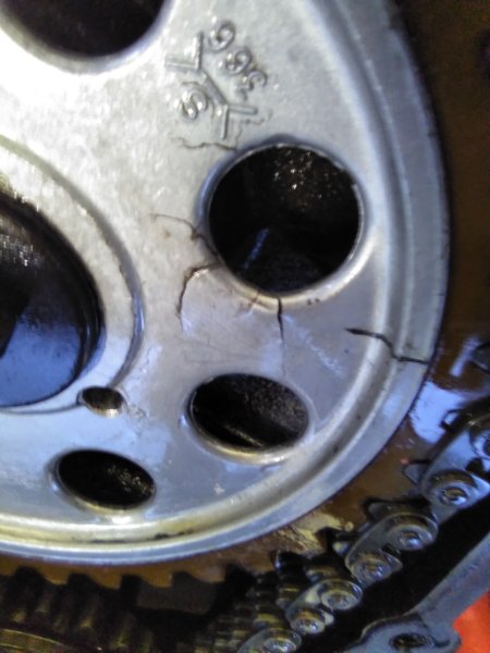

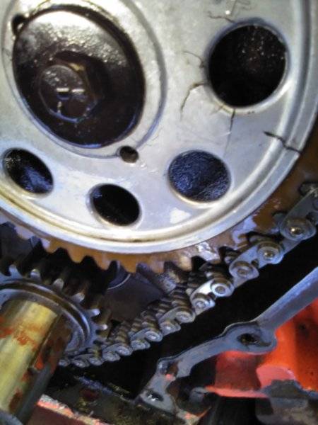

Tore apart yesterday found original nylon gear set cracked and split.
Anyone ever seen this before ?
Thanks Gripper
It's 60 years old. You need a new timing set. I can see the loose chain from here.

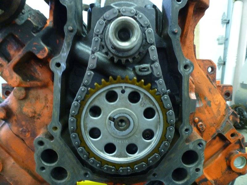

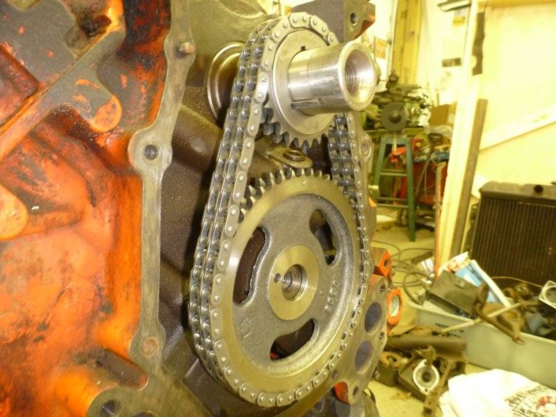

They were cheaper and quiet, usually they schuck the teeth. Put a good Rollmaster double roller on it. You are lucky that you caught at this stage.

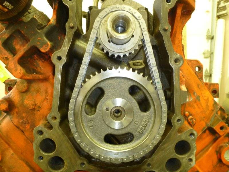

Mine made it at least 40 years, engine rebuilt in '76 and I changed it 2016. But who knows if it was even replaced back then...
Usually you find all the tooth plastic in the pan...
