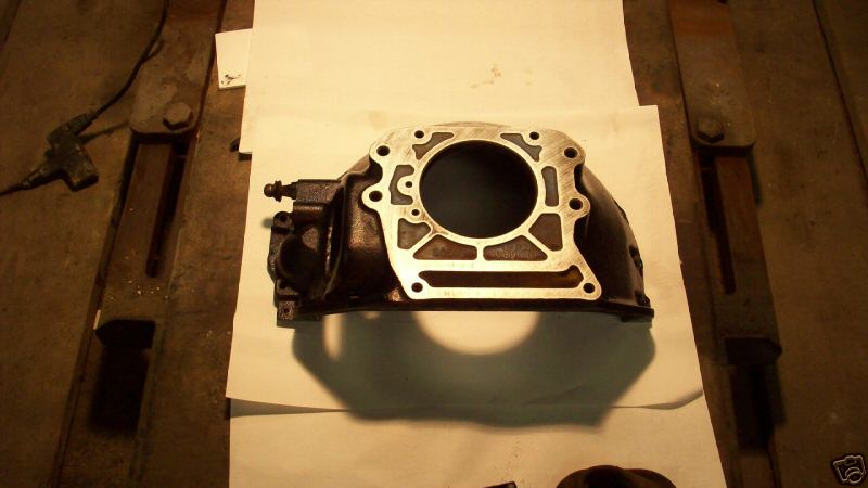

They only made one later really hard to find BB 833OD bell which also fit the NP435/445 truck trannys. #4039670. It takes the 143T flywheel.
Can machine out the hole on a car bell and machine down the hub on the OD tranny to mate and use the 130T wheel.
