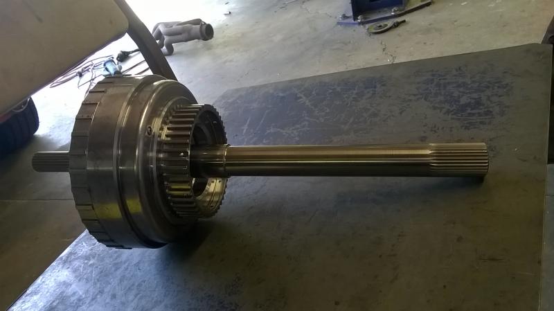

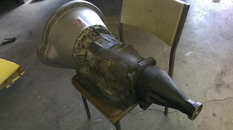

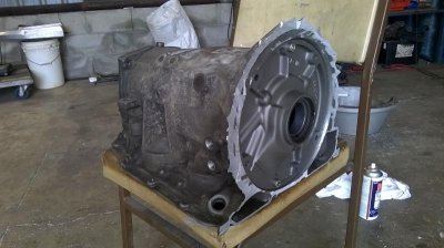

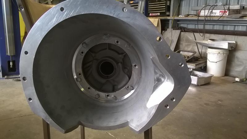

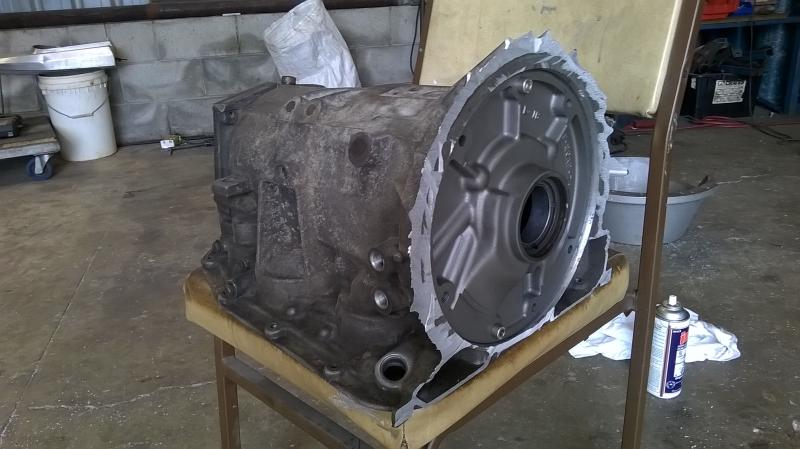

its sure good to have the overdrive,saves driving at at 2800-3000rpm to do 65mph,instead 1700-1900 rpm ,I am building a ford AOD for my 505 1972 road runner built to handle 700 HP it uses JW powerglide bellhousing,JW billet 4340 flexplate and chev style converter.have to cut ford bell housing off and jw bolts to pump and centres on a machined pump housing.it uses stage 1 rasbestos frictions 6 forward 4 intermediate ,7 direct.has 4R70W gearset 2.84 ,1.55/1.00/0.70 OD,has manual Valve body with overdrive on solenoid switch.this is a fully hydraulic trans no computer.check out silverfox transmissions in Missouri,he builds 950 HP handling ,FB performance in new York builds 1200HP handling.this trans cost me $5800AUD with conWP_20150101_08_34_34_Pro.jpgWP_20150101_12_19_34_Pro.jpgWP_20150101_11_41_24_Pro.jpgWP_20150101_13_33_36_Pro.jpgverter

Holy crap! That transmission sounds like a wild assortment of parts! Ford AOD in a Powerglide case? That is unusual! All this to fit in a Mopar??? Crazy!
