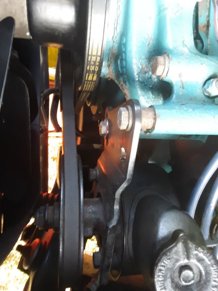

Hi Mike,
Here is a picture of what I had to do to get mine lined up.
(It is a repop bracket) and saginaw pump.
You can see the spacer I made behind the bracket. There is another on the bottom also. 440 engine no AC.
My motor is a late 70s 360 out of a pickup. I used the Stock one. After taking all kinds of measurement and mixing and matching pulleys I was able to get it all in line. It's been fine.
