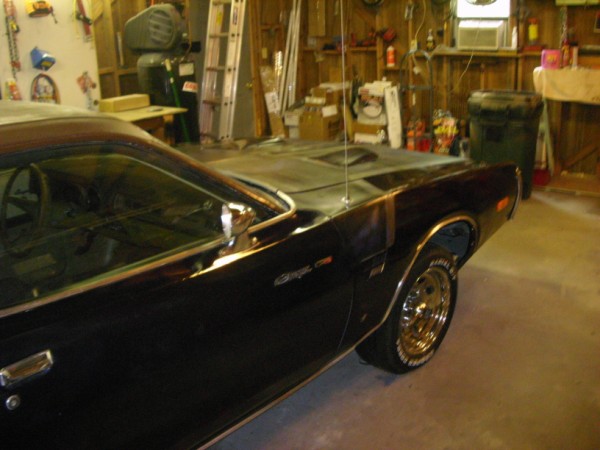

I'm working on the body of my 66 Coronet, and I'm having trouble getting the layers of paint to even out with the rest of the car; what is the best way to tackle this situation?

Use a sanding block, paint paddle, something to wrap your paper, then keep it flat against the body of the car. Sand as large an area as needed to feather out the repair you're working on. You can't try to keep it as small as possible and expect it to feather right. How many coats of paint are you trying to feather? If it's more than primer and two coats, odds are you really should strip that panel, and if it's really old paint like enamel with no hardner, you'll almost certainly have to strip it, cause that stuff's almost impossible to feather right.
once you have it feathered out, primer over it to help build the area back to the paint level, sand, primer again, and repeat as necessary. Depend on FEEL to tell if it's feathered more than how it looks. Lay your whole hand flat, and move it quickly with very little pressure to see how the panel feels. If you can feel a disturbance and not smooth metal, it means it need more work.
There seems to be more than two coats of paint for what i can tell. There is also bondo under some of the paint in certain places. Would stripping the paint cause damage to previous bondo? And what is the best way to strip the paint?

i can definitely tell that the paint layers are making it uneven. I'm just having a lot of trouble evening out the paint itself. Im using a block sander I picked up from Home Depot, and an electric hand sander from HarborFreights.
So far, I have been pretty successful with the bondo, but when it comes to the toop layer of paint that has been chipping of the car, I can't even it out.

i put a 220 grit sand paper on the electric sander and went over the spots, and it seems like it is really helping. I'm going to keep working on it another day when i got more light.

The electric sander is actually a finish sander, and it moves pretty fast to be trying to work that paint down. The sanding board would be better for it in the long run. One mistake almost everyone makes (me included) is to try and use power tools where we actually should be using hand powered. With the powered sander, keep it moving. Don't leave it in one spot to try and work down that particular place. Always moving, semi circles over and around the spot you're trying to repair.
What type of sandpaper are you using? If it's the normal brown quartz paper you get most everywhere, cheap, it's going to take you one heck of a lot of it to do what you're doing, and in the long run, more than a decent quality automotive prep sand paper. Check an auto paint supply store and get some paper there. You'll be glad in the long run. At the very least, 80 grit to rough it in, 220 to finish before you prime.
I'm one that likes power tools. Air sanders are to hard and fast to use at home. But an electric DA like a Dewalt with practice will do 90% of the work for you. You do need to get a good set of automotive sanding blocks, summit has everything you need.
