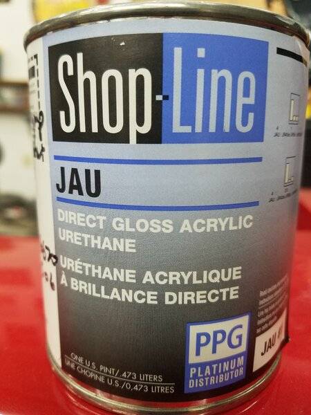

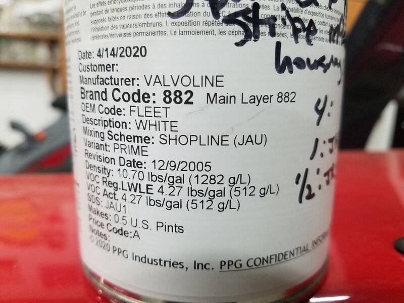

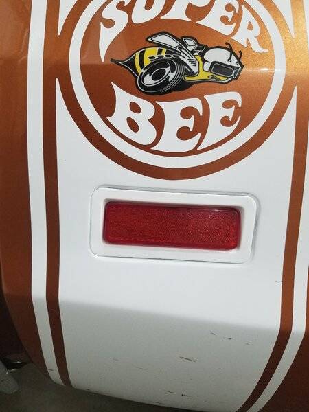

I used this on my Bee. The stripe should be the same color as on your Charger. Matched real nice.

I forgot to ask you did you use a separate clear coat after the color
This is a single stage paint. I believe it was David (RIP) from Performance Car Graphics, where I got the stripe, who recommended it.
