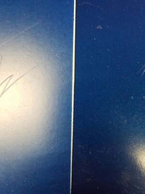

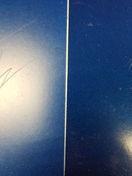

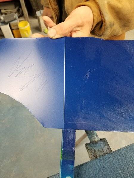

@CudaMerf : Recommend only get enough base color to do a spray out on test panel to ensure its the "shade" of GA4 to YOUR liking before buying all needed to paint car: Revisions to the "batch make-up" over the years may not be to your eye liking. Regardless of which paint brand. left side "new revised" 2018 batch, right was pre-2018 revision's batch, right side is it for me. GOOD LUCK
