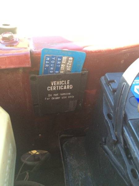

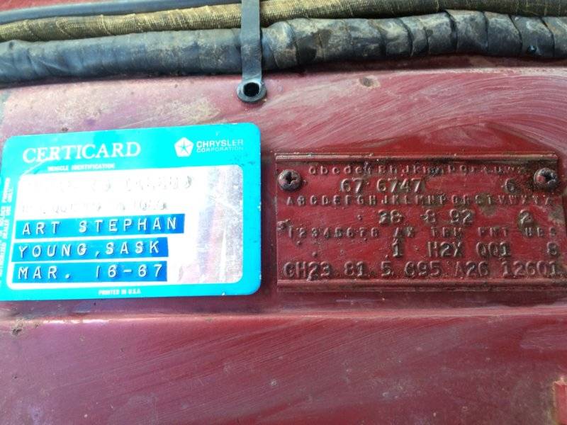

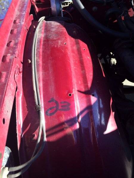

This is from one of the most original cars owned by my family, 67 New Yorker- 68,000 orig miles, garage stores etc. Beautiful original car since sold. This is an original marking (23), only one I have a pic of. I am including the certicard just because it was also that cool on a 50 yr old car.

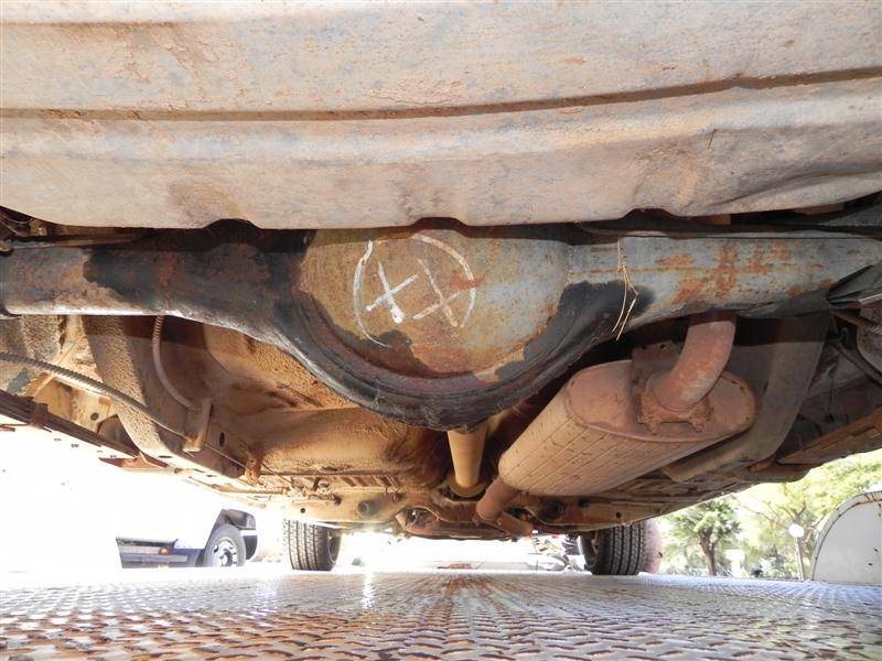

67 Charger, listed for sale years ago, the story goes, protecto plate original owner was general motors pontiac division. The car was sold with a taped telephone conversation, talking about a day that the rear window blew out while they, GM , were testing the car. Have no idea where it ended up, but somebody does. here are some rear end markings.
