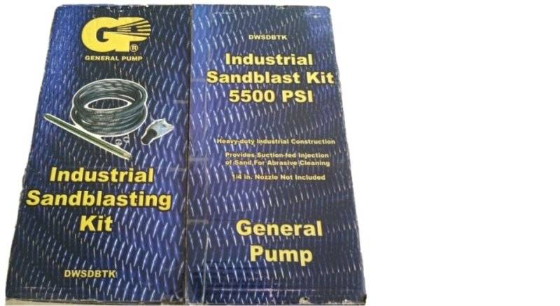

If the material can be moved outside and you have or can rent a 4500psi+ pressure washer you could buy one of these
General Pump Professional 5500 PSI Sand Blast Kit​
General Pump DWSDBTK Professional 5500 PSI Sand Blast Kit
I have one that I have used on a kitchen table and chairs. I also bought all of the nozzles from general pump. I have had this thing for a years running 1000's of lbs. of media through it. You can adjust how much media you pull through it. I stripped the table top and chair seats with Kleen strip and blasted the table and chair legs and chair backs with glassbead. I stood farther back when blasting wood than I do when I blast metal. I only had the original finished to remove so I'm not sure how it would work in your application. I also used compressed air to dry and moved everything inside the garage out of the sun to avoid warping as it dryed. It also works awesome on wheels, cleaning white letter tires, metal, sheet metal, cement and brick. If you don't stop once you start you can pull soda through it. I have used play sand, silica sand, black slag, aluminum oxide, silcone carbide and other media but over all varies sizes of crushed glass works the best for me overall on metal. I only used glass bead on wood as it worked so I never tried the other media.
