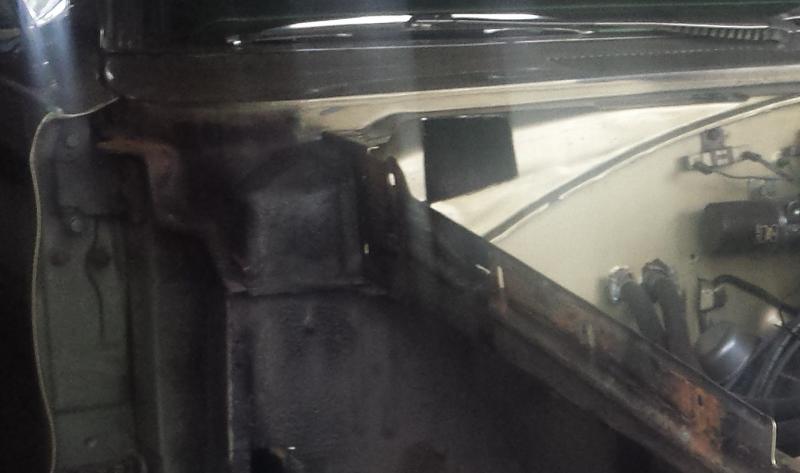

Thank you - that is what I was afraid of as I saw no other way.either. does anyone hav a pic where it was cut?
Here's where I cut the opening in mine. Enough space to clean out drain properly, clean up any surface rust where water has been sitting, check venturi seam (I put seam sealer over mine) and then spray primer / topcoat. 20151228_180939 (2).jpg
