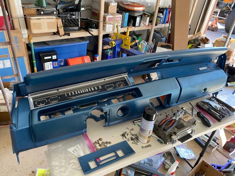

I used SEM upholstery paint to change the Coronet's interior from saddle tan to black. Used their rattle can Landau Black. Its all about the prep work. In addition to the paint you need to clean the material then use vinyl degreaser and lastly an upholstery primer. I used a grey Scotchbrite pad with the degreaser to get into all the nooks and crannies.
It's been five years and the drivers side arm rest has a few flakes, but the lower dash pads and door cards still look great.

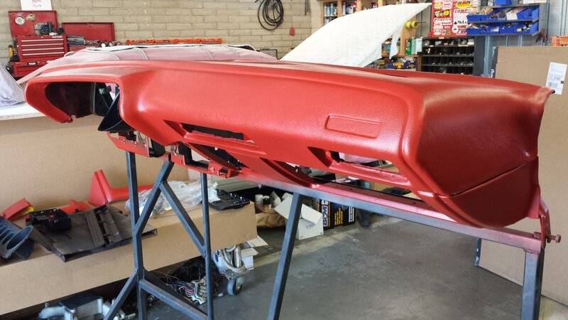

64 polara 500 its the bright read from legendary the now I have is a dark red repop
If you want a dead on match get the color lot code from Legendary and call Kolor Korrect in NJ. They will mix it for you. Check out Bull dog adhesion promoter also.
I'll second Herb's. Match is dead on and application and adhesion is excellent. They ship fast as well. Just buy more than you think because shipping is a bit high for a single can.
