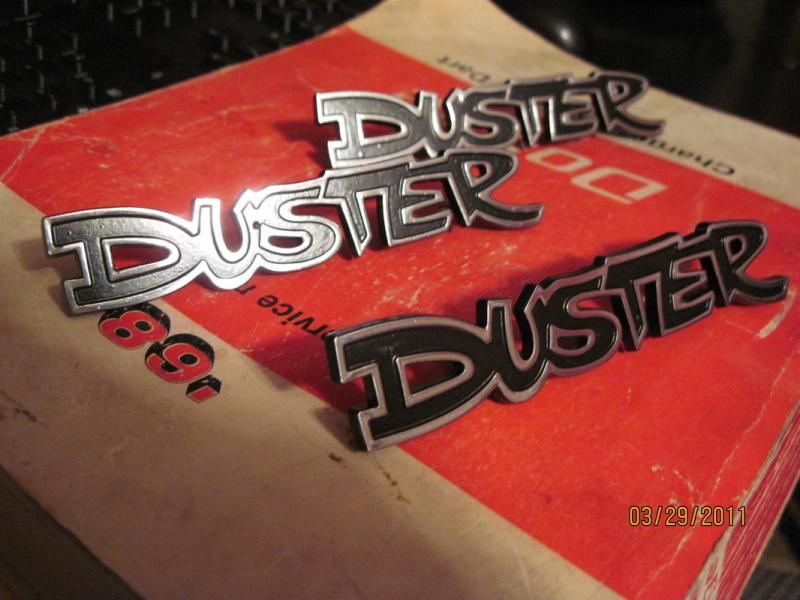

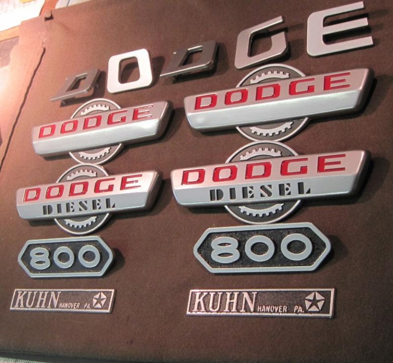

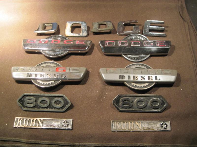

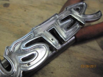

Be careful heating them up too much -- lots of those trim / accessory pieces are pot metal which doesn't take heat very well unless you know what you're doing. These pieces can be restored though. Here's a couple Before and After Pics to illustrate.
