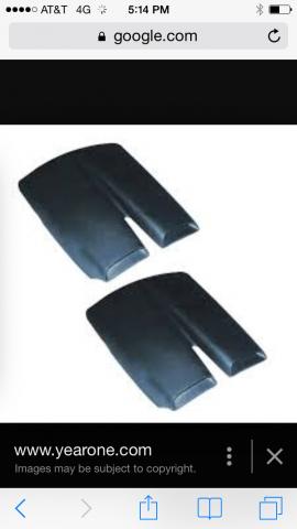

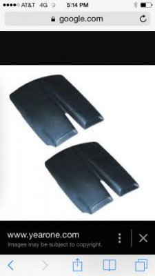

Found side scoops, not easy to find. Also some move pics. can't wait!
