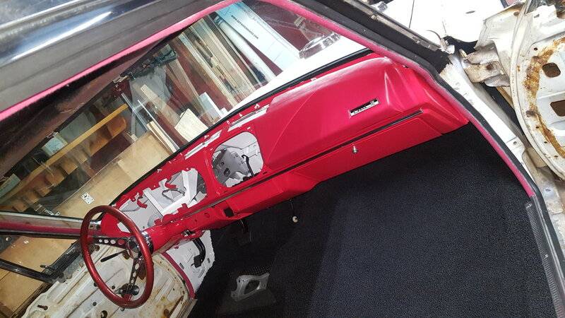

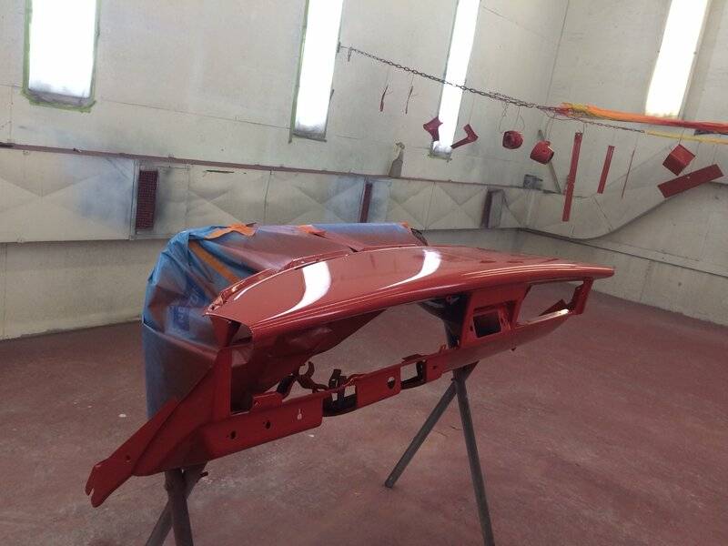

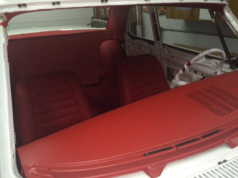

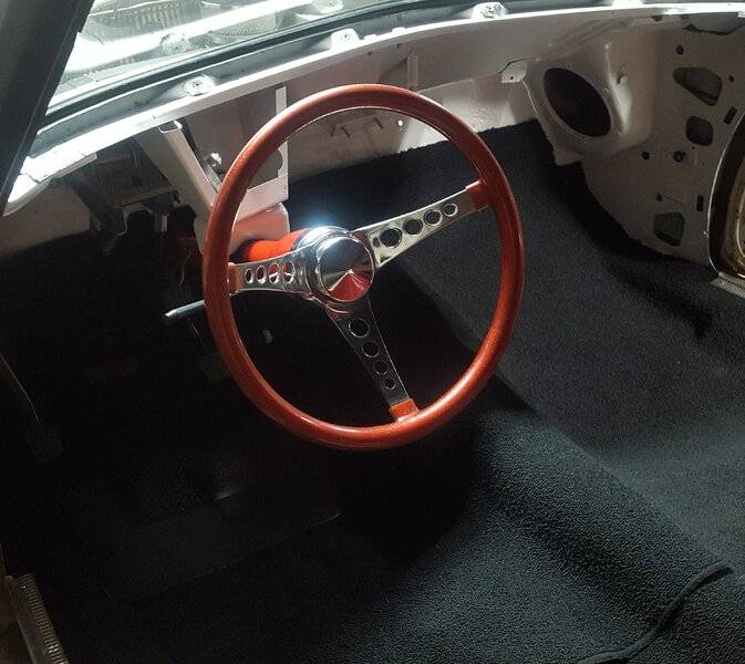

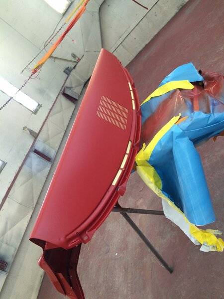

On my 65, there are screws along the windshield edge of the dash and a bolt on the lower left and right sides of the dash.
I installed my dash while the windshield was out.
