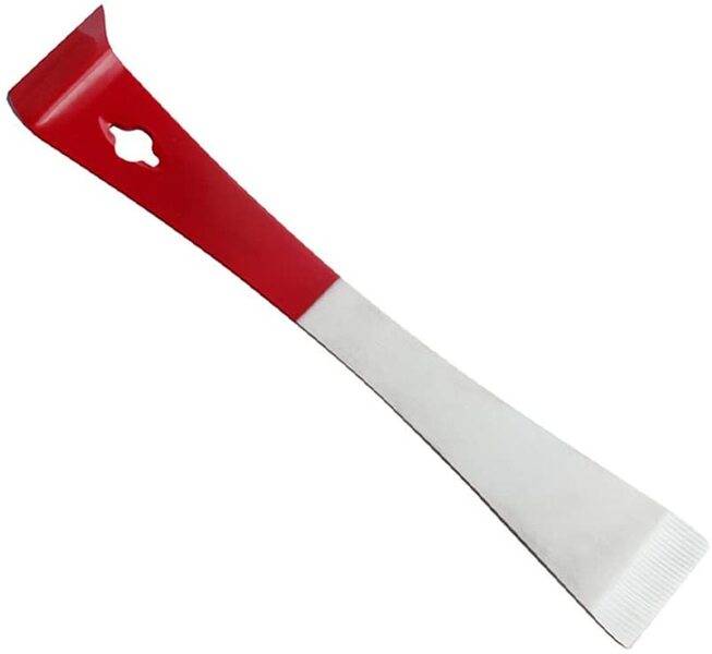

Think this would work?

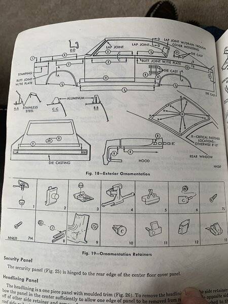

I was just posting pictures of the clips that are used for each moulding. So you can either wiggle the moulding lose or a clip tool. Or un bolt from the back. The little book is handy. I got it with my car .
