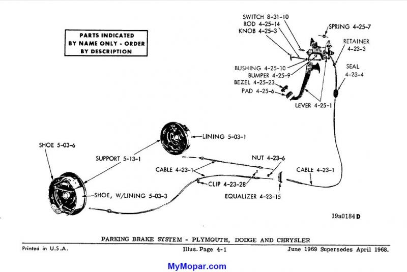

Need some help on what I need. Car came with the parking brake cables cut out and have seen a few variations of what is needed. Shop manual diagram is not very helpful. Need to know, on a 70 Charger, do the left and right rear cables connect directly to the equalizer or is there another bare cable that humps over the equallizer and this cable connects on both sides to the left and right rear cables with those connector clips. Hope that makes sense. Don't want to order all this up and be wrong. I am guessing the left and right rear cables connect directly to the equalizer but not 100%.
And also, Autozone has these rear cables listed as being ones for cars "with front drum brakes". Does that make any sense why there would be a difference in the cables if it had disc or drum in the front? I am assuming it is a typo and they meant to say rear drum brakes.

You need 3 cables like shown in the propwash illustration. I have all three original cables here in good used condition if you need them and i would not purchase the zone ones. Last ones i bought for a Dodge van pulled right through the brackets when the brake was applied they where a POS PM me if interested
