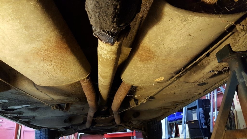

I have a '63 Plymouth 318 with dual exhaust. As I understand the dual exhaust for the motor wasn't available but it was on the '62. The parking brake cables to the rear wheels are routed underneath the exhaust pipes and can't find any drawings showing the routing in my factory manual and on the net. It doesn't seem right the cables would route under the exhaust for a number of what I'd think are logical reasons; but who knows I've found other engineering tidbits causing me to scratch my head. Anyone have some knowledge to share?
Thanks!

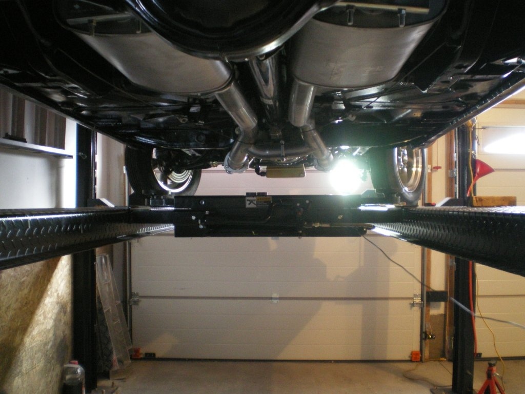

Lucky you, here's my sixty two! (361 hp)

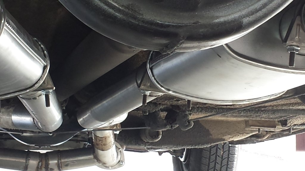

that's how mine are routed, pipes angled upward cables under...
Thanks much for the info!

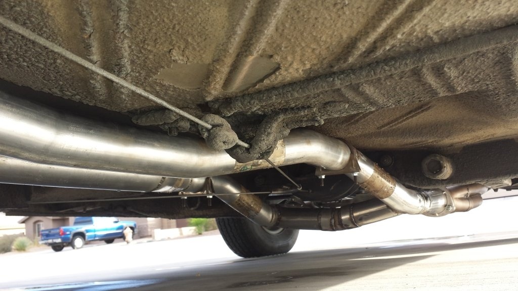

Here is a pic of my 62, same setup...
Thanks I had new exhaust system install this past week and exactly how cables are routed.
