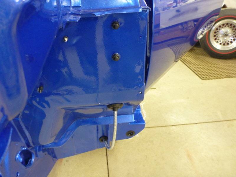

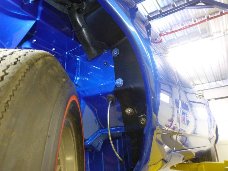

I think the two nuts in the wheel well are not behind the splash shield they are directly above where the cable comes through the fire wall
Yep, glad someone is paying attention!! LOL

Just glad Beekeeper was paying attention and you didn't tear the shield off already! Soak those nuts really good in rust breaker and if you can use a bit of heat before you try to turn them. They have a bad habit of snapping off the studs.

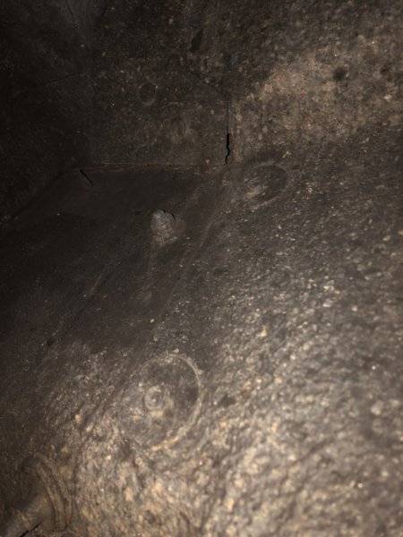

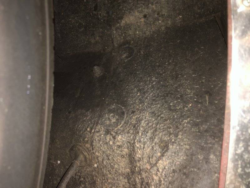

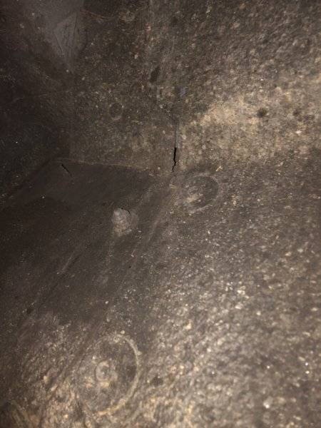

I took some photos tonight, here is what John's 1970 Roadrunner looks like. I think I see one of the 2 nuts, the other must be under the shield.
Yep, flap is just sitting over it... you should be able to push it up above the nut or lift it up enough to access.
