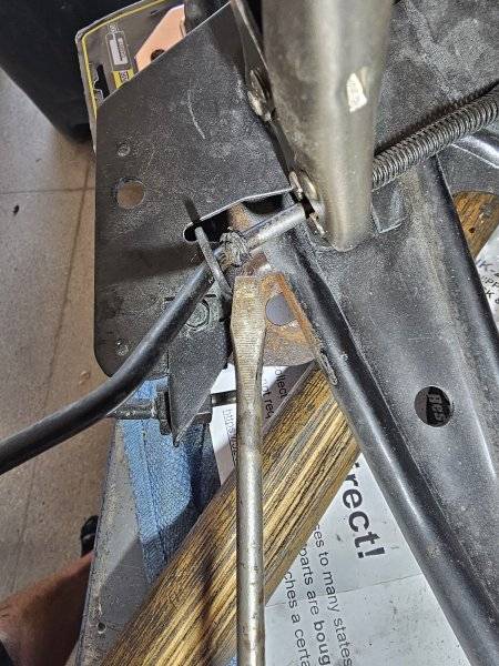

Looking to see if there's a source for the parking brake handle spring retainer.For lack of a better name.
Or maybe someone has a creative "fix"
screwdriver is pointing to the plastic retainer that is broken

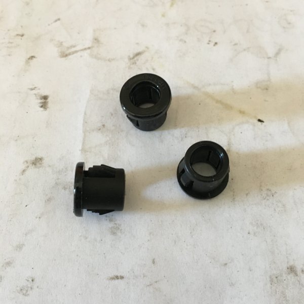

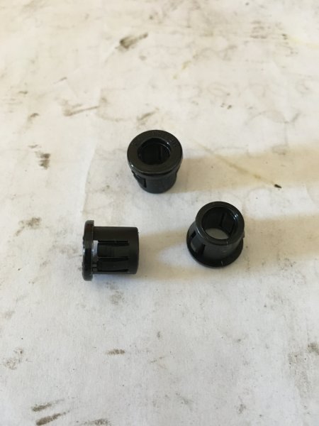

I have a box of those. Not "identical" but they serve the purpose. Got them at a nut and bolt supply. They're called "snap in bushings"
