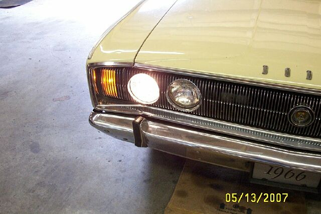

Are the parking lights supposed to stay on with the headlights on a 66 belvedere?

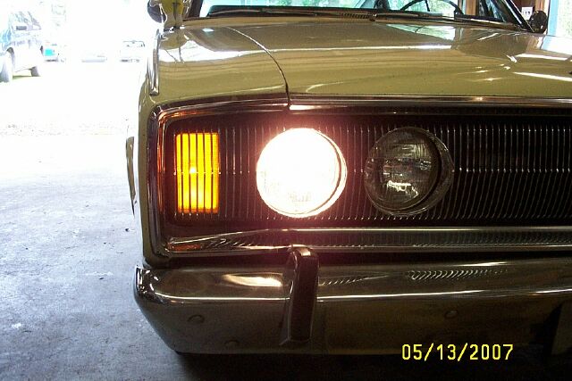

but you can make them stay on with headlights buy taking the front parking light wire off the headlight switch and connecting it to the rear tail light circuit....that way front park lights will work the same as the rear lights
Cool-that's one of the reasons I like the 66-the cat eyes parking lights!Thanks.
I did it to all my Chargers...here is one of our 66's
