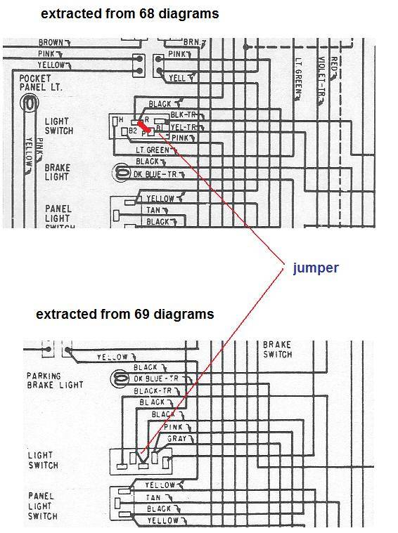

Between 68 and 69/70 headlight switches remain the same and only added a jumper wire on harness between rear parking lights and front parking lights prongs at switch plug. Switch itself is the same. So you could find the prongs and make the same

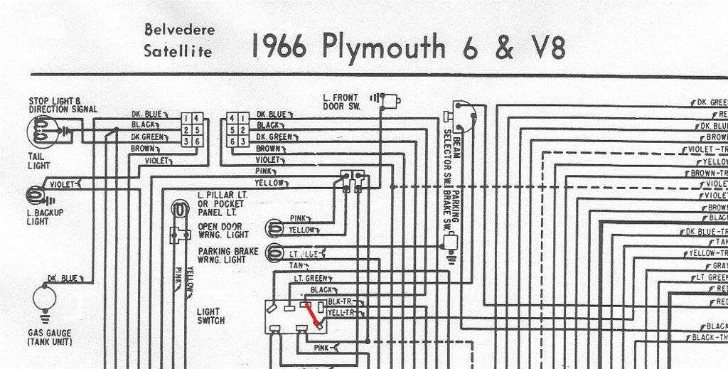

Hey thanks guys. So if i understand correctly i just need to make a jumper wire between the black and yell-tr wires? With that being done parking lights should come on with headlights, and no problems with my turn signals correct?
yes, that will make the front parking lights ( yellow traced circuit ) will stay on being sourced also from the rear parking lights circuit ( black wire ) instead just the front parking lights circuit once you turn on the headlights, where originally they are cut
ad same jumper wire here if you want they stay on while headlights on
