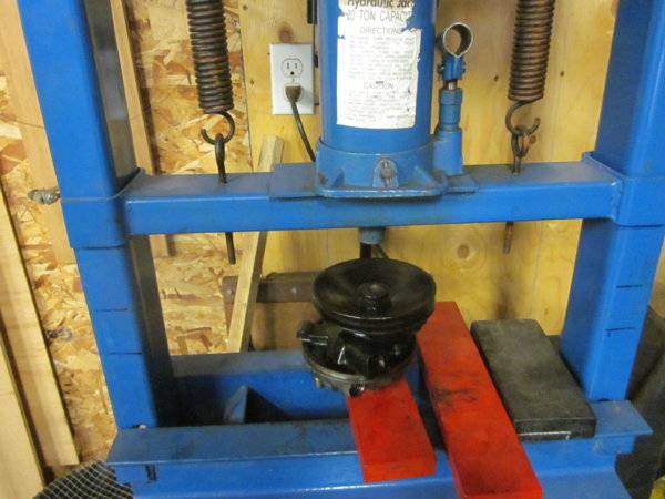

Does anyone have a part number and where I can order one of these pumps?
The pump was on a 1964 Plymouth with a 361. If I must rebuild myself how do you press the pulley back on? Thanks..
Press the pulley on with the res off. Supporting the non pulley end of the shaft with the support bars on a hydraulic press. While pressing it together it Doesn't hurt to put brass or aluminum at each end of the shaft to protect it.
That's exactly what I needed. Thank you!
