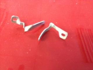

wind clips.jpgI know these go on the windshield trim but where?

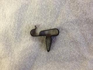

The chrome clips go on the bottom end of the windshield moulding near where the top of the door and top of fender come together. There should be screw holes there unless the were filled in. The black clips are for the fuel lines & brake lines along the underside of the body. The larger ones fit the fuel lines and smaller ones fit the brake lines.
