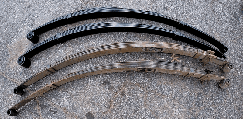

I've never measured mine, but the top 2 are wagon, bottom 2 SS.
62 b-body would be the same as 2nd gen a-body.
