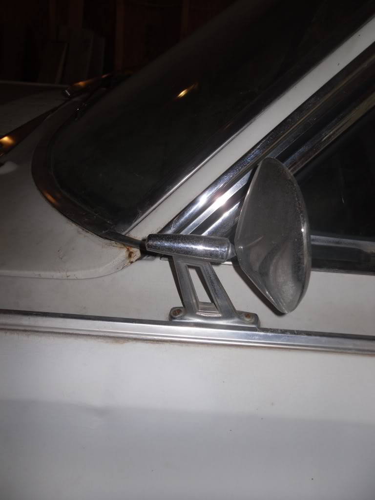

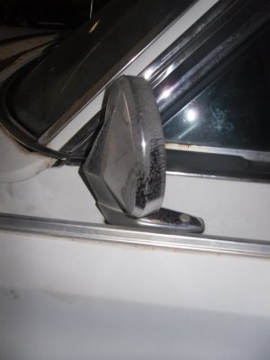

Just picked up some parts and there was a passenger mirror with the stuff has penstar emblem on lower outer edge also the mirror neck has two prongs instead of one any help on what it goes to, thanks
Is it a remote mirror? Here's two pictures of mirrors that are both correct for a '66-'67.

The "double posters" fit either side.
For the others, there is a manual and a remote model...and the guts are different- both manual/remote and left/right.
Interestingly, both types have the same spacing between the mounting screws, but the "remote" style (bottom pic) has one a bit larger.
I just bout two pass side like the bottom pic at two different swap meets and made a manual driver's side from the worst one (using a remote driver's side I already had).
I was shocked (and frustrated)at all the internal differences.
