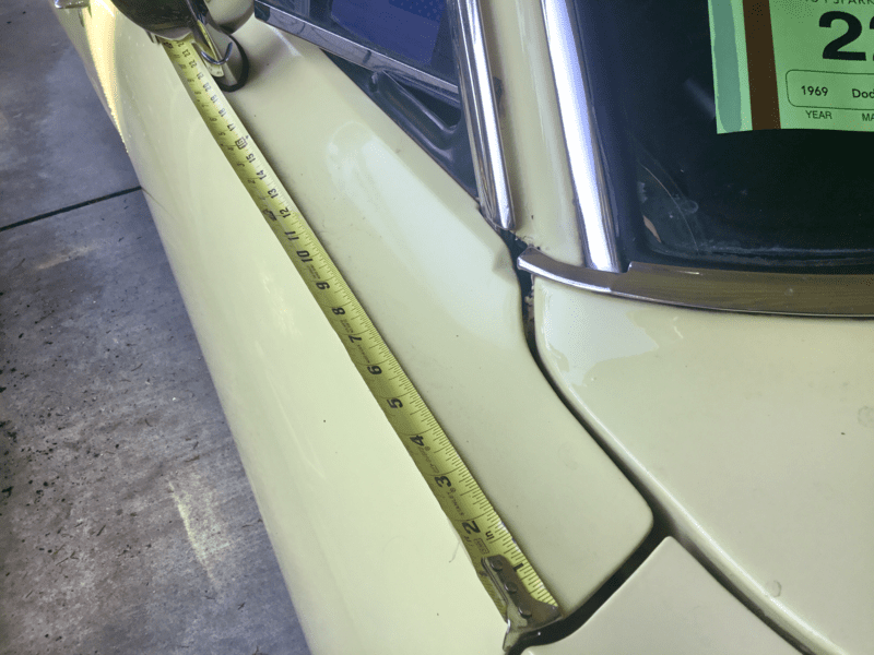

I recently added a nice original one to my 69 Road Runner. Backing into my single door garage without it, was a bit daunting. As mentioned above, placement is critical. I measured the dimensions on the drivers side, but using those, the mirror was placed behind the post (too far forward) and was basically unusable. I moved it rearward 1/2" and it was perfect and not really noticeable side to side. Also, my driver mirror appears to be tilted slightly inboard at the rear. Not sure if this is by design, or it was remounted incorrectly at some point. Bottom line, make certain you have enough range of adjustment to be able to see out of it from the drivers seat when backing up. Also, do NOT over tighten the nut! (DAMHIK) Snug it, and use a dab of Loctite. Take your time and enjoy the results!

I've been thinking about installing the pass. side mirror also and was wondering if anyone with a factory installed mirror could measure their's so we can know what what the factory did .
there's a pass side mirror mounting template in the FSM
I used the guides inside the door. Maybe the mirror was wrong.
