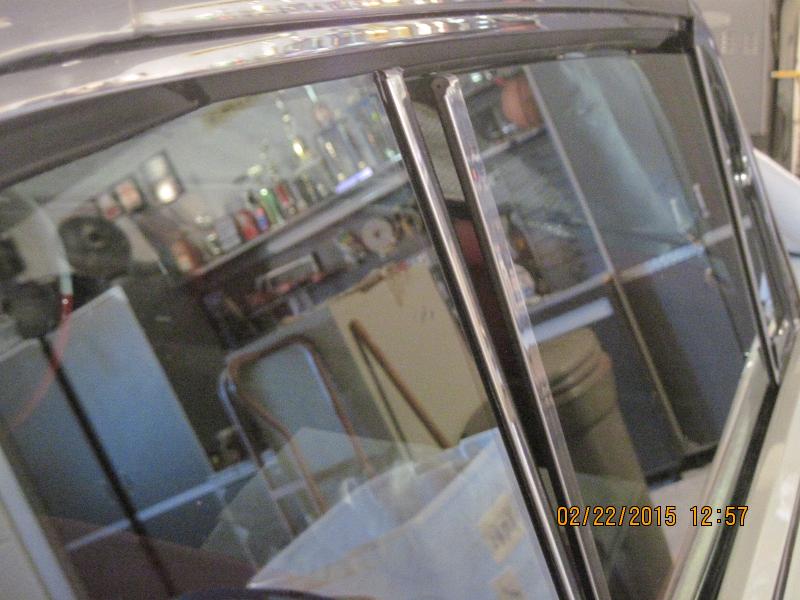

Just got my car back from the body shop, putting it back together, noticed that my passenger window does not line up to the rear window( car is a hard top), it is off by about a half inch. Does any one know how to adjust so that it fits? Has to be something on the door panel....Thanks
Assuming that the whole window/vent window assembly has not not removed, I would say that you might want to look at the rear window track. However, to be sure, take a picture so we can see which way it's off.

IMG_3664.jpg Here is a picture. I did take out the winwing assembly, prior to going into the body shop
window adjust
Looks like you'll nee to remove the door panel and make some adjustments. The factory book will give you a step by step. If you study the attachment points of the window mechanism, you can figure out which screws to loosen for which movement. Or better yet if the window fit when you took it to the shop, ask the shop to put it back where it was.

yes I did, just took some time but was easy thanks to all who helped.....
