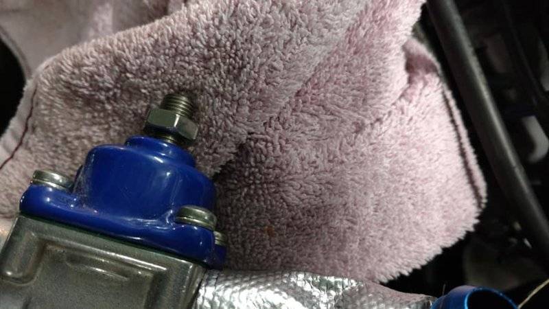

You should check your fuel pressure regulator. Sometimes the loosen up.
Thanks to Member PRHeads for steering me in the right direction, the lock nut on the regulator came loose & some other things added up to no fuel volume, pressure was 6 psi but no volume.
