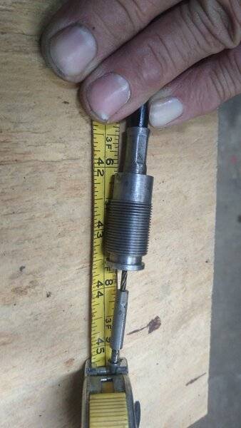

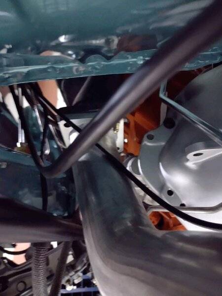

Looking for a 48" length Push Button Shifter Cable, for my '63 Dodge MW project. Turns out, the 42" /6 cable will not easily clear the MW Ex manifolds. The 48" cable was the length used on All BB applications, 361,383,426, so Hoping someone has one collecting dust, on a shelf ?

Rob, it may ? I don't think the '65 B-bodies had PB, but some C bodies had them I believe ? I'm using a '65 Cable shifted slip yoke, and think the ends are the same ? The 48" length is what will work for my app. Check the length, and let me know, Thanks...

Jim, would that be for a Console shift, like the 500's had ? I'll try to look that P/N up today, Thanks.
I've got one that's close to 59" from a 63-64 Chrysler 300 pushbutton trans
Jim, I found that part#, it comes back for ALL '64-65 with a console shift, so it probably has different ends on it, compared to a PB application. Thanks for looking on that !

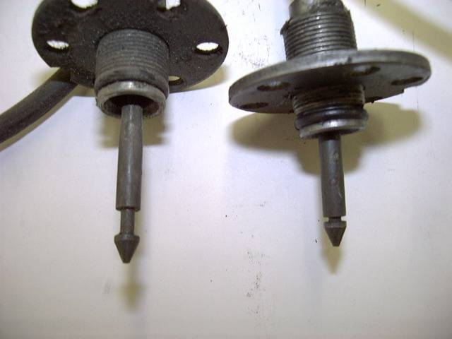

The 1965 cable will NOT work on the earlier PB transmissions unless the valve body has been switched. The reason is the ends on the cables are different. The 1965 shifter is cable operated by floor or column shifter but doesn’t use Pushbuttons to select gear
The 1965 cable has a larger groove and is shown on the left in picture.

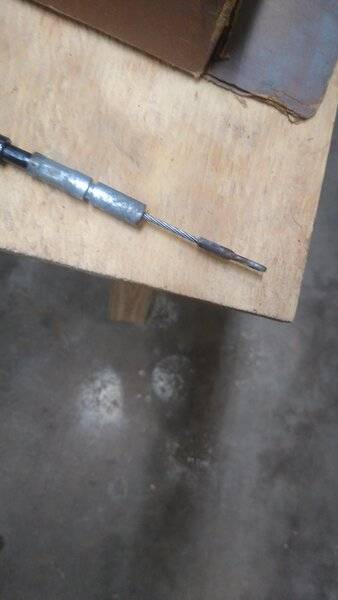

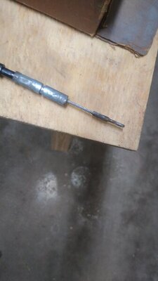

I just looked at my spare cables The ends are the same for the 63 push button as the 65 console at the rooster comb. Have never seen the wider groove cable?
