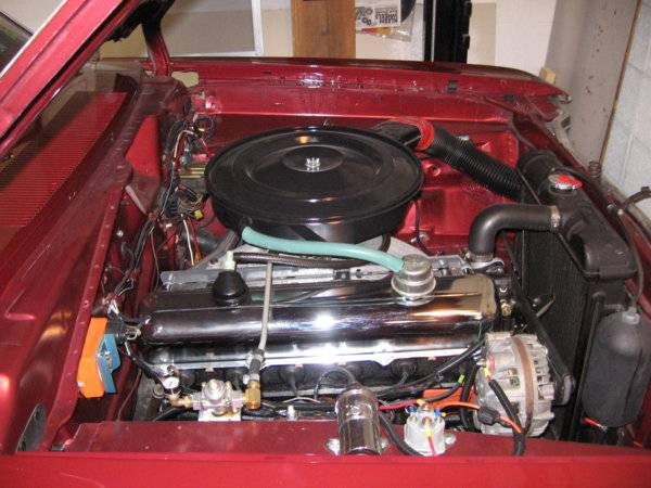

Stock Valve covers ? Aftermarket ? You may want to try a pre-breather breather cap.Works with both. Autozone part# 8078. I install it first and then install the PCV into the breather cap.(The black one)
You can see it in the photo. I know you have a V8, but I learned this from the Slant Six web.You may have other problems but wanted to pass this along.
