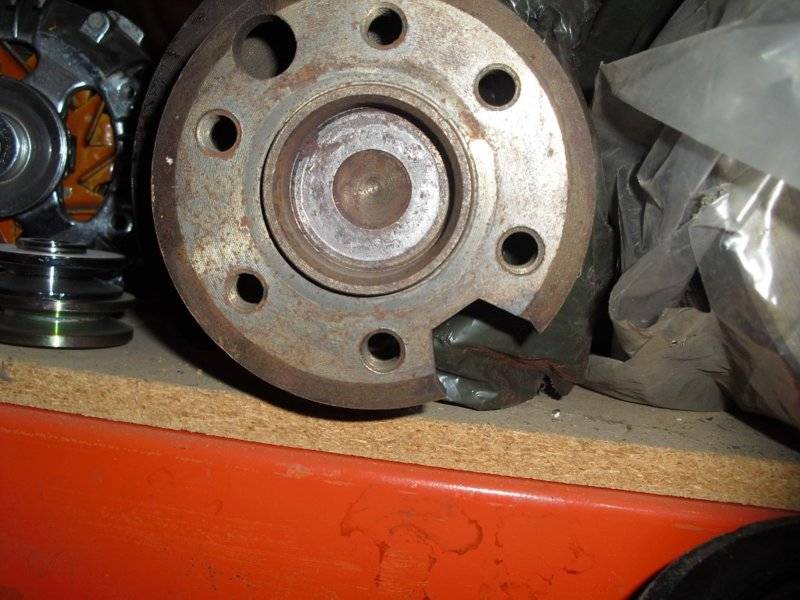

Many BB cast cranks are not drilled at all for input shaft clearance, these are the ones that need to have the input pilot shortened.
