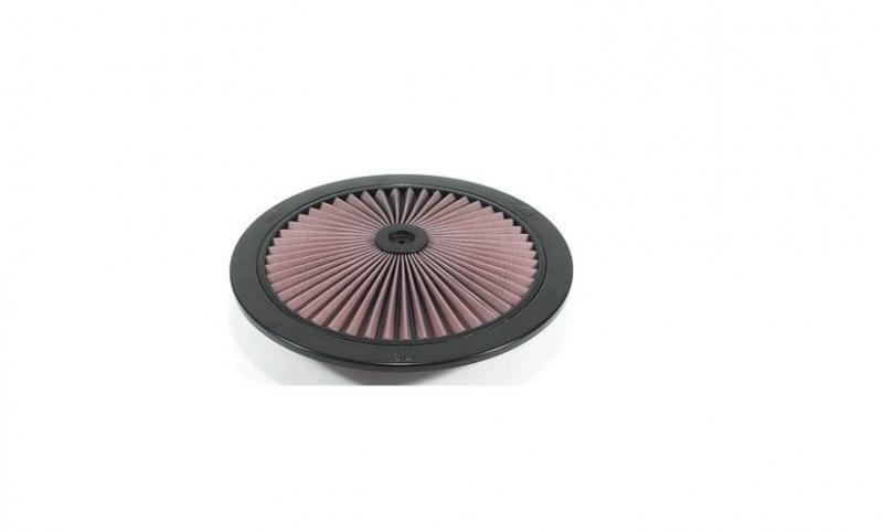

Get yourself an air filter top like the K & N Extreme and you won't have to worry about it choking your motor dpstark2. Recessed for the wingnut as well
