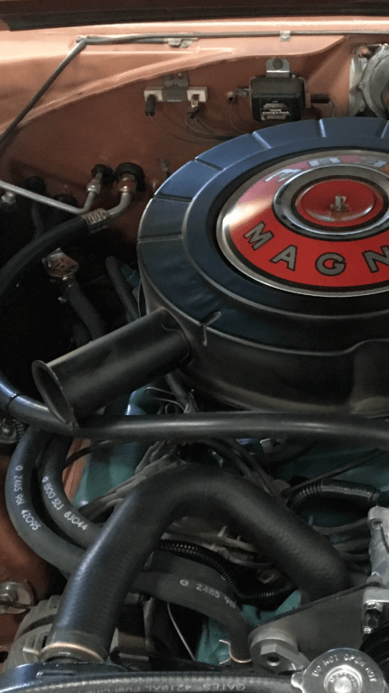

I have done this on the car pictured below
Pertronix wires directly to the coil.
Bypass the ballast resistor by removing the resistive element from the porcelain and replacing it with a solid piece of copper. This maintains the "factory" appearance.

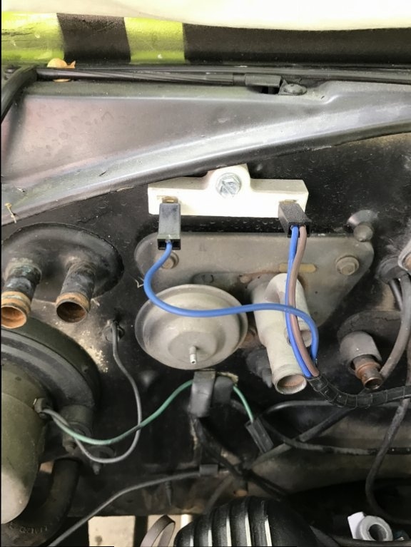

I just teed into the twin wire connector on the right side of the ballast as per their instructions on paper
