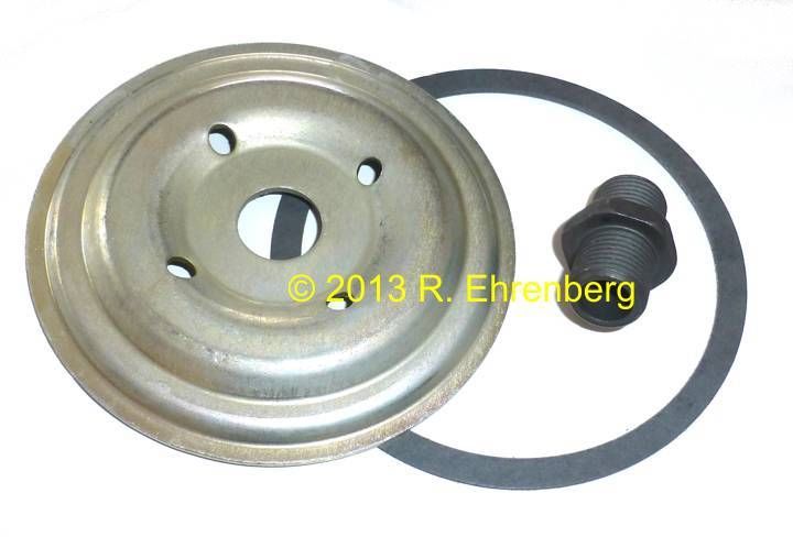

I have had a leak coming from the oil filter adapter
I removed it and replaced it since the nut was on backwards
It is still leaking....
Any tricks to getting this on correctly and sealed?

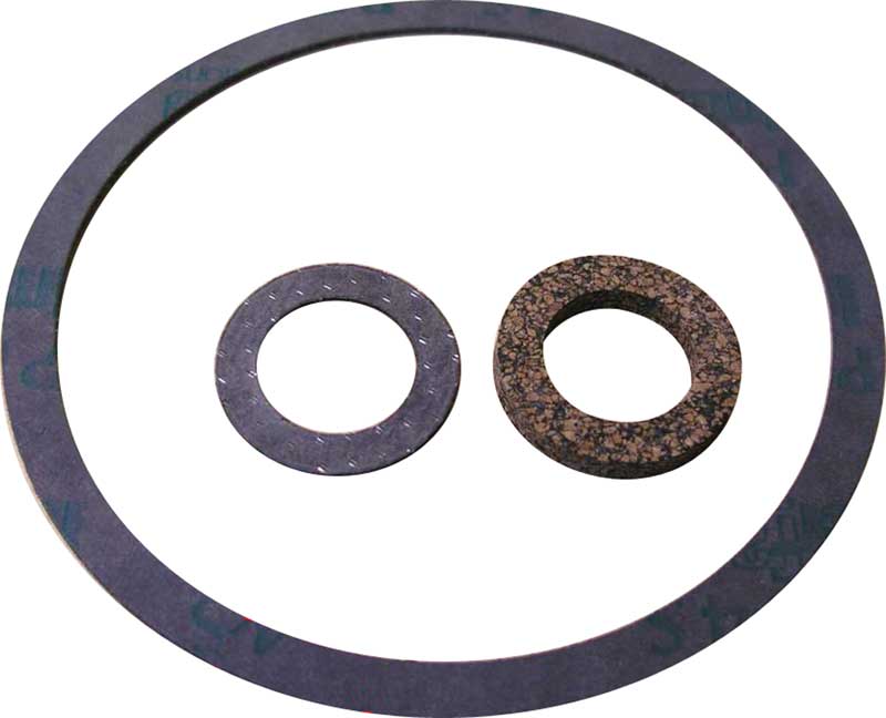

Replace the gasket, and make sure it is the large ROUND one only, not the one with the with the inner peace symbol, or the small inner gasket. They will not allow the adapter to clamp the larger outer ring properly, and it will leak.
