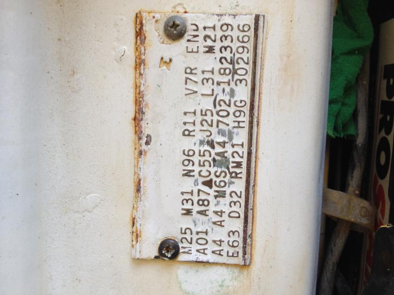

I have a 69 a4 roadrunner that originally came with the m6s interior option. From what I can tell that was vinyl bucket seats. Black and pewter. We're the seats and door panels etc. Pewter with black carpet dash and headliner or what? It also had a v7r stripe. What is that? When we got the car years ago it had black bench seat rabbit fur covered black door panels and painted white.

V7R is a red accent stripe that in 68 was painted on the car and in 69 was changed to reflective tape. Let me see if I can find my other book before I go to bed and I can give you an answer on the interior.
According to my book, someone can correct me if I am wrong. It is showing bucket seats- silver/black, carpet- black, door panels- black with silver armrests, headliner-black.

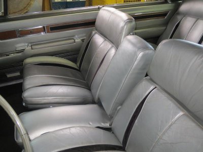

My '67 Imperial has what the codes call gray leather but if this is gray then I'd love to see what they call silver.

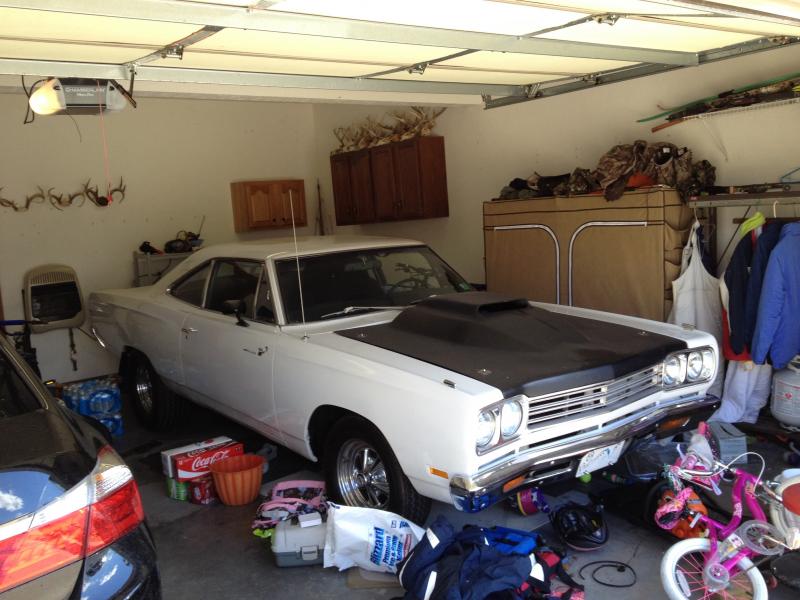

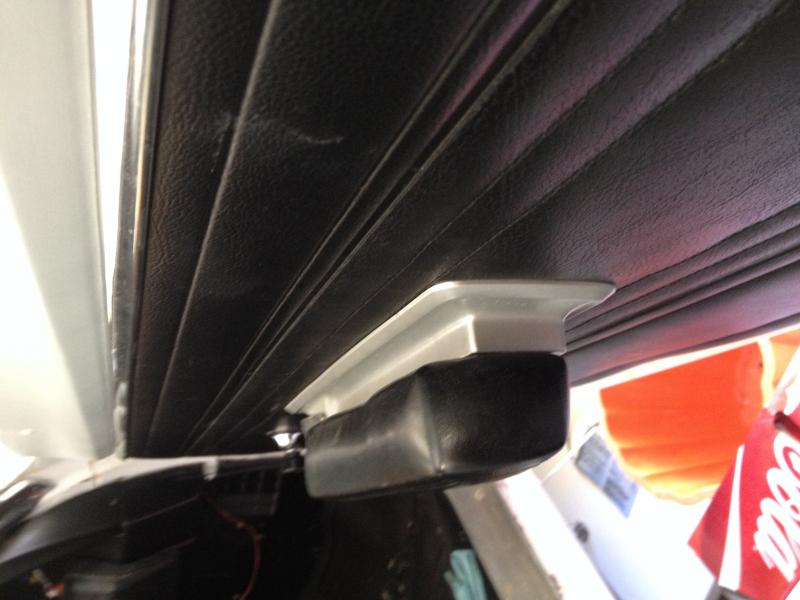

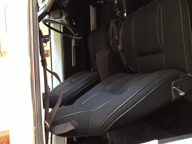

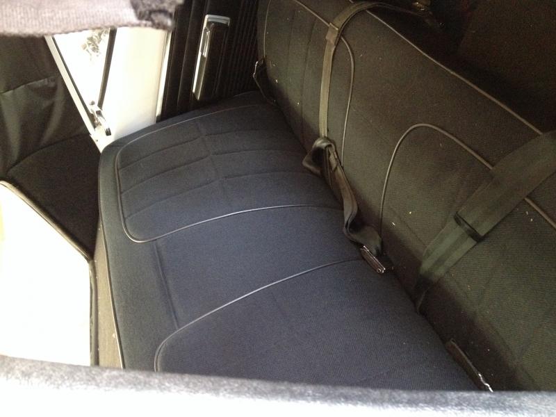

Here's some pics of what it looks like now. All I need to do is repaint it and change the seats. It has all new metal. I have an air grabber but no ductworkJust waiting on cash flow. Any sponsors out there in mopar world? I would trade the seats in it for a decent set of original buckets.

The wheels will be called out on the build sheet.
A87 is decor group and consisted of vinyl trim(H2 or M6), rr armrests w/ashtrays, B-pillar moldings(RM21), exhaust tips ( except w/N97), partial horn ring steering wheel, bright door trim panel moldings & bright armrest bases.
Those seats look like they've been done in matching materiel. Someone may want to buy or trade an original set of front and back for the complete set. If you wind up a a bench offer those are pretty desirable too and could raise some funds or be trade materiel for 69 buckets. Just a thought I don't know how much you want to mess around
The fronts and back are matching. Had them done a few years ago and they are perfect shape. Bolt in and go. I will trade front and back for a set of buckets and back.
