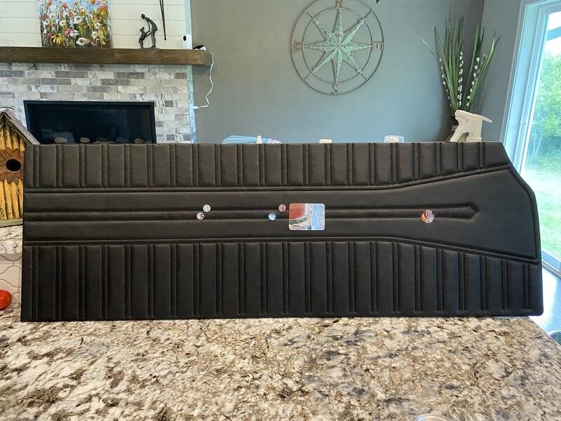

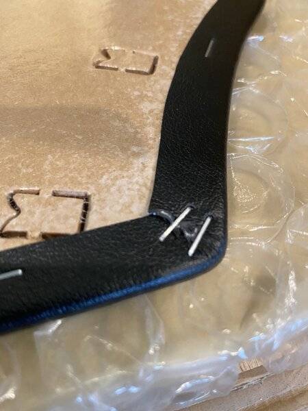

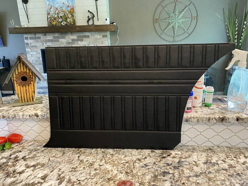

For those that are curious about PG Classics door panels, here’s a quick overview.
Shipping - When I placed an order I was promptly notified that my order was received, and tracking information will be providedonce the door panels were marked shipped. Within a few days (I placed the order over the weekend) an email came through from UPS as well as PG classics with the tracking information. The panels arrived on time, without issue.

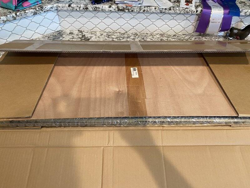

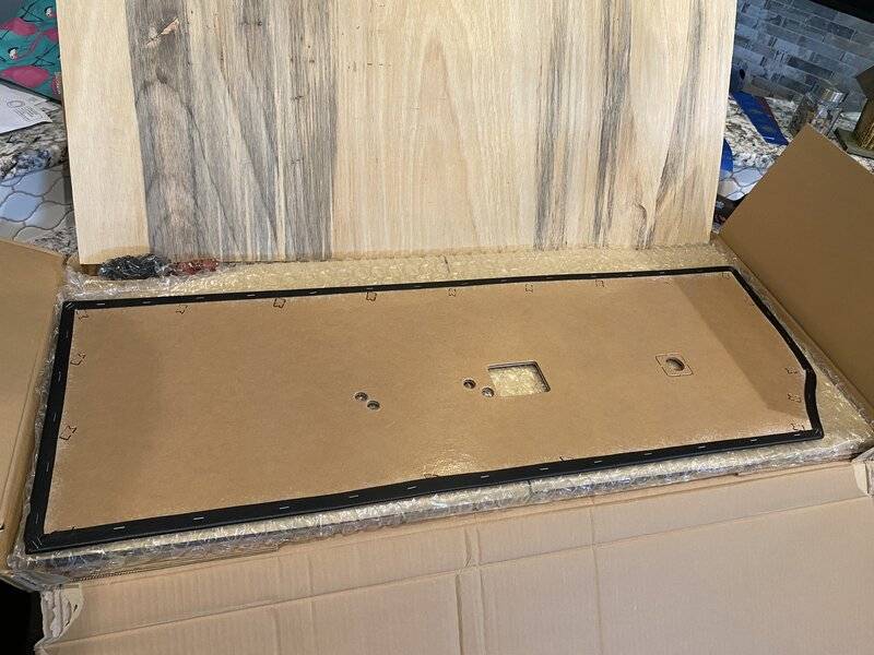

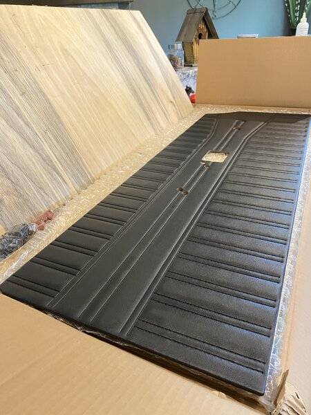

Packing - Both the front and rear panels were tightly packed and separated with bubble wrap, wax paper, and a thin sheet of wood. I was pleasantly surprised how well these were packed to be honest. No complaints.
Panels - I did a little searching around prior to ordering these panels and I couldn’t really find any criticism that would have steered me in a different direction. A lot of the posts that I did find, though, were from years ago, and from a business standpoint, I assumed improvements were made in their products since. So I took the chance. The result? A good, driver quality product. The lines are straight, they’re structurally sound and the fabric is secure. They also included mounting clips, which is was an added bonus.
Note - I have not had the chance to put these on the car, but once I do I’ll update the thread.
Here’s a few pictures.
Cheers.

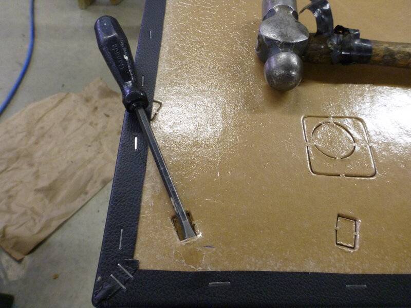

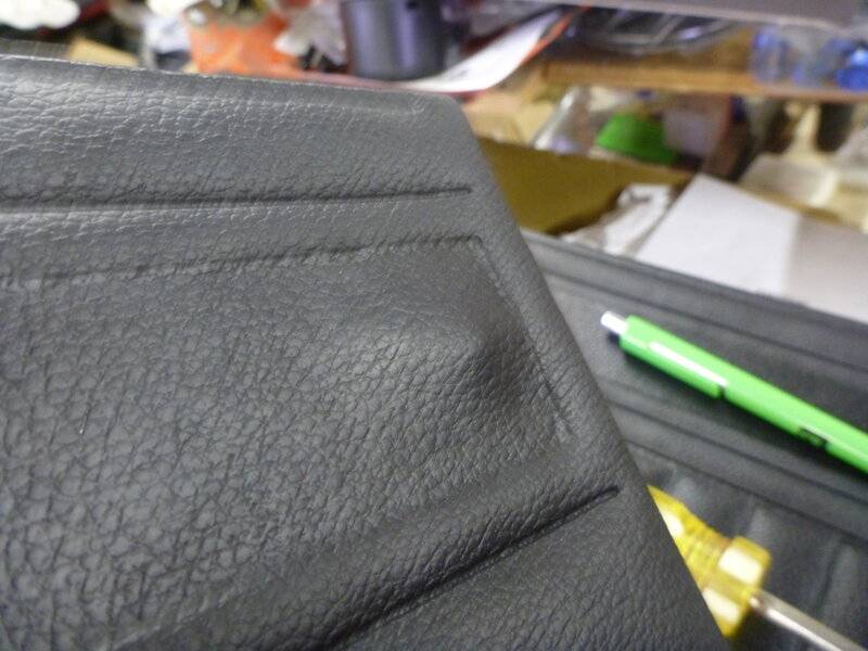

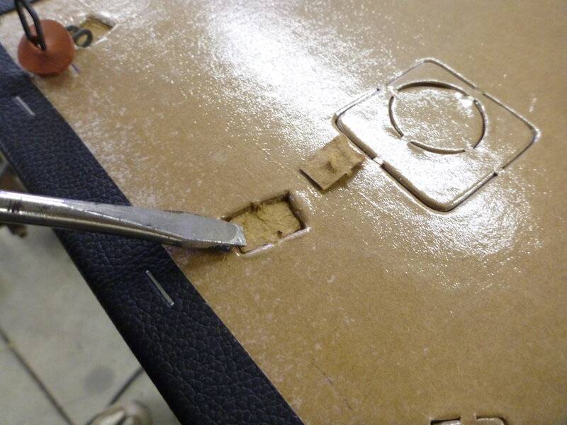

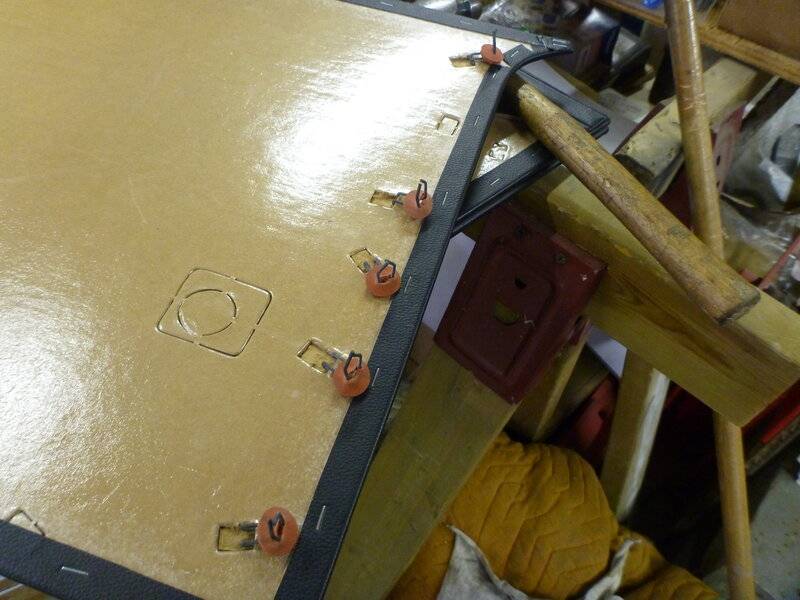

when you do go to put them on the car, DO NOT remove the prestamped cutouts completely or your clips will all show through the vinyl. Carefully remove 1/2 the cutout slot so there's enough left to hide the clip..
